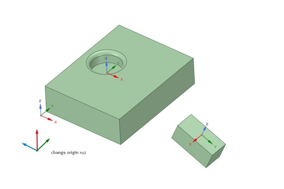

    • vincent.rouillot
      hello Gaurav_ANSYS
      Unfortunately, I was lost the axis with z in vertically. I can turn all my model in 90° degree but in my case it’s my origin who isn’t the good direction. How I use the function origin to turn it ?
    • vincent.rouillot
      Yes, it's not easy to express myself today, "Conception and the icon created", it's mean The function origin, with the icon xyz bleu, red, green can create the origin but not manipulate the first origin. The way to fix my problem is turn all the object... but it's difficult with assembly constraints.

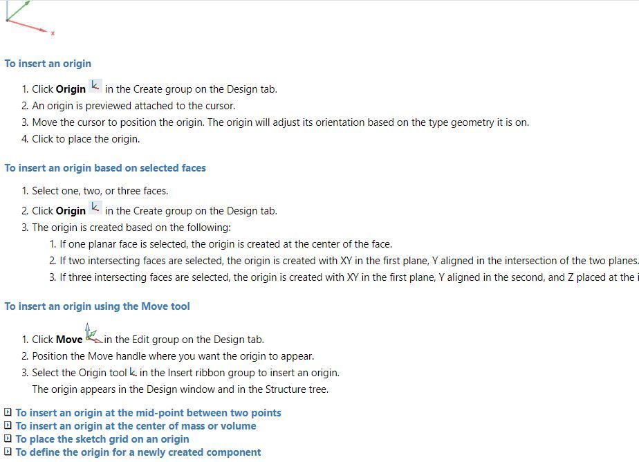

      • Gaurav Sharma
        Vincent Rouillot
        If you have access to SpaceClaim, place your cursor over “origin” icon and hit “F1” on your keyboard. The corresponding help page should open for you:
        This is how the page looks like:
        As mentioned in my previous mail, the help document consists of several ways to manipulate the origin. Which among them is best suited for you, depends on your application/requirement. I am still unable to understand what is your specific problem i.e. what do you desire to achieve by manipulating origin. What steps you are following and what observations are you having. If you can please provide me with more details, I may help you better.
