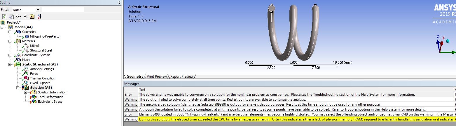

      I want to analyze shape memory effect in Workbench>Static Structural. I take help from ansys demonstration guide of shape memory alloy thermal effect. In cahpter 40. spring actuator of shape memory material nitinol. From this link:
      https://ansyshelp.ansys.com/account/secured?returnurl=/Views/Secured/corp/v195/ans_tec/tecsmatesimuthermal.html?q=shape%20memory%20effect

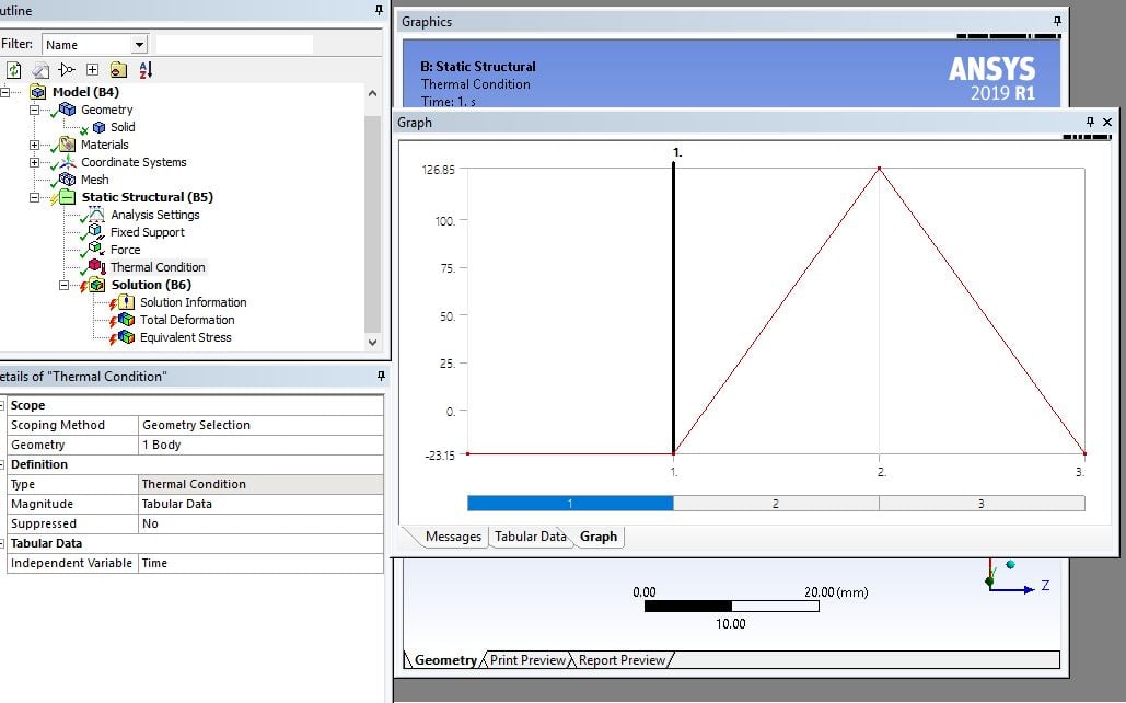

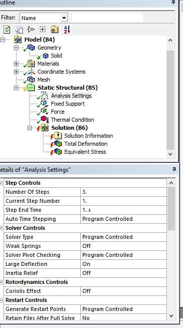

      But in this demonstration here use Mechanical APDL. I want to do it in workbench. So, I add nitinol material in engineering data. Add shape memory effect and superelasticity data. During analysis, suppress superelasticity data. As I want to check thermal effect and elasticity, so I use shape memory effect. According to demonstration, I add material properties, made a spring using SolidWorks, Give force, fixed support and also thermal condition. Analysis is 3 steps process according to demonstration. Steps output should be like this-
      The top of the spring actuator is fixed, and the bottom is loaded with a weight of 100 N (I check several weight). Displacements are constrained in the X and Y directions. (step1) After the spring is stretched by the weight at temperature 250 K, (step 2) the temperature is raised to 400 K to lift the weight, and then (step 3) is reduced back to 250 K to lower the weight.
      But It's not working. It's not showing any thermal effect and also no large deformation. it shows-
      "The solver engine was unable to converge on a solution for the nonlinear problem as constrained.  Please see the Troubleshooting section of the Help System for more information."
      I did'n understand where I made mistake? How I can get same type result (Demonstrate in chapter 40: Shape Memory Alloy (SMA) with Thermal Effect for spring actuator)  using Workbench>Static structural?
      I have uploaded my analysis images in my post for better understanding.

      I got help to find SMA analysis from your referred post. But still I face some problems. I get those error messages. What I have to do to solve the problem?
