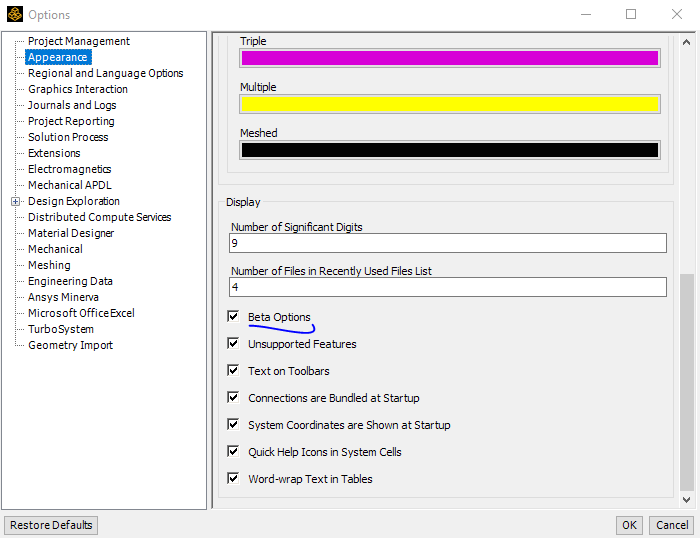

      Another thing is that condensed parts (super elements) is available as a beta option in static structural so you can explore that perhaps also.
      Erik
    • Erik Kostson
      You would need beta options activated to see that:
      Hope this helps
      Erik
