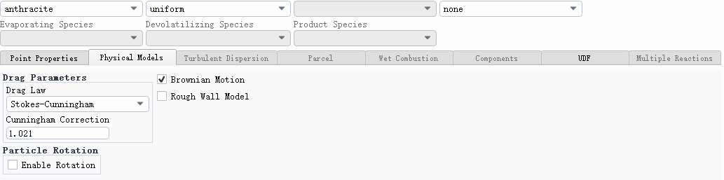

cs_zy
SubscriberMarch 21, 2022 at 6:41 pmAmine Ben Hadj Ali
Ansys EmployeeYou need to code it again as an additional force which you can then store for each particle as particle scalar
March 22, 2022 at 10:52 amcs_zy
SubscriberThanks´╝îDrAmine. Programming Brownforce with UDF? And then export it? How should I do?
And Can I get the momentum exchange between the particle and the fluid´╝ƒI know the formula for momentum exchange between particles and fluid. Can I use this formula to define an expression in CFD-POST to calculate the specific value of momentum exchange´╝ƒ
Really Appreciate.
