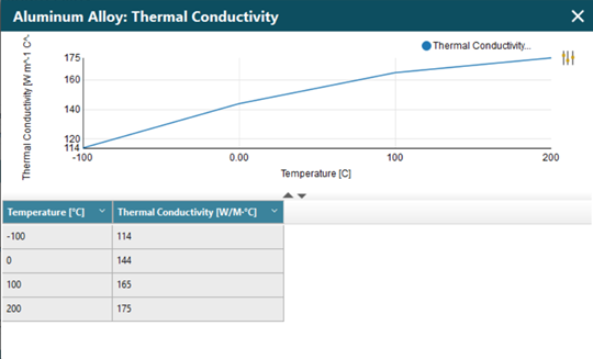

I was using ANSYS (2021R) Steady-State Thermal and was wondering how the program determines Thermal Conductivity if the value is dependent on Temperature.
For example, for Aluminum Alloy, the plot is as followed:
December 7, 2021 at 7:46 amVinayak Vipradas
Linear extrapolation is used within the temperature range specified. However, if the temperature falls below or rises above the defined temperature range of tabular data, then ANSYS assumes the defined extreme minimum or maximum value respectively for the material property outside the defined range.

December 7, 2021 at 4:37 pmjstapchuck2
SubscriberOkay thank you, So for my example, ANSYS would just use 114 for any temperature less than or equal to -100 C.
December 7, 2021 at 4:45 pmVinayak Vipradas
Yes, ANSYS would use the value of thermal conductivity as 114 W/mK for your example, for any temperature less than or equal to -100 degree Celsius.
