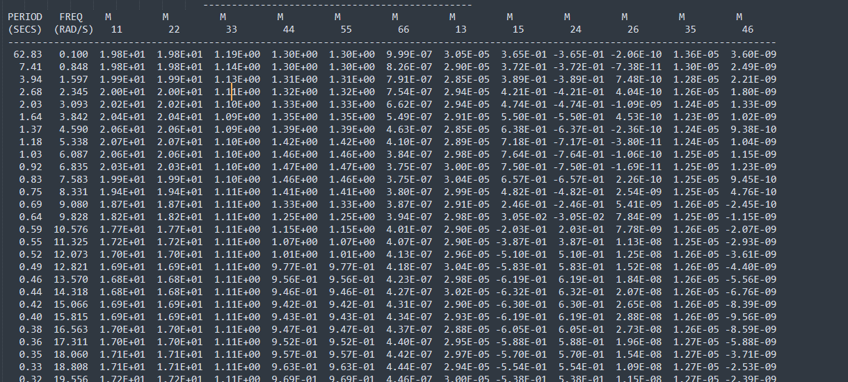

SubscriberThank you for suggesting an interpolation method. I did have a look at the Analysis.LIS file, but it seems like for the added mass and radiation damping values, only 2 decimal digits are printed. How do you get the exact value with a good number of significant digits.
And I am not sure how to enable the AH1 file either. Could you please point me to the steps to do that?

February 3, 2022 at 7:25 pmaakashg57
SubscriberApologies for bugging you again, but how do I setup more digits output? In theory, I would like to just copy paste data from the picture I posted. Thank you. I'm new to Ansys.
February 4, 2022 at 3:23 pmYu Bi
Ansys EmployeeNo, there is no setting to change the value digit in the output file. The picture you showed doesn't contain the whole matrix. *.AH1 file, the results directly exported from Aqwa Workbench, and the full added mass matrix in the LIS file have more digits in the result values.
