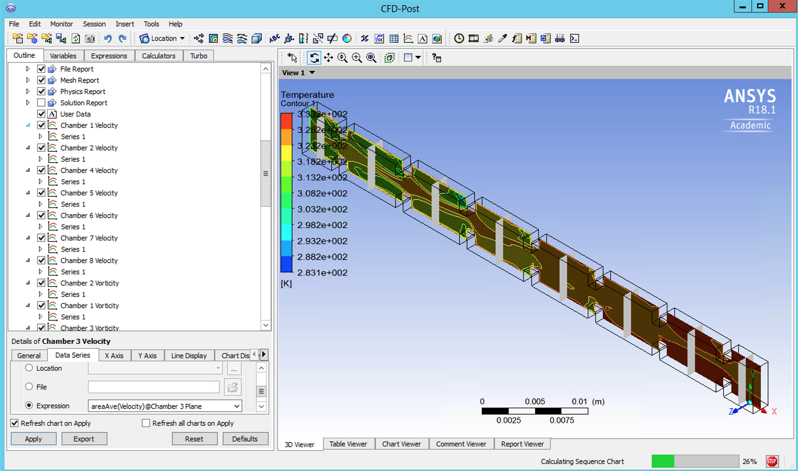

SubscriberI don't understand why it is taking so long using CFD-Post

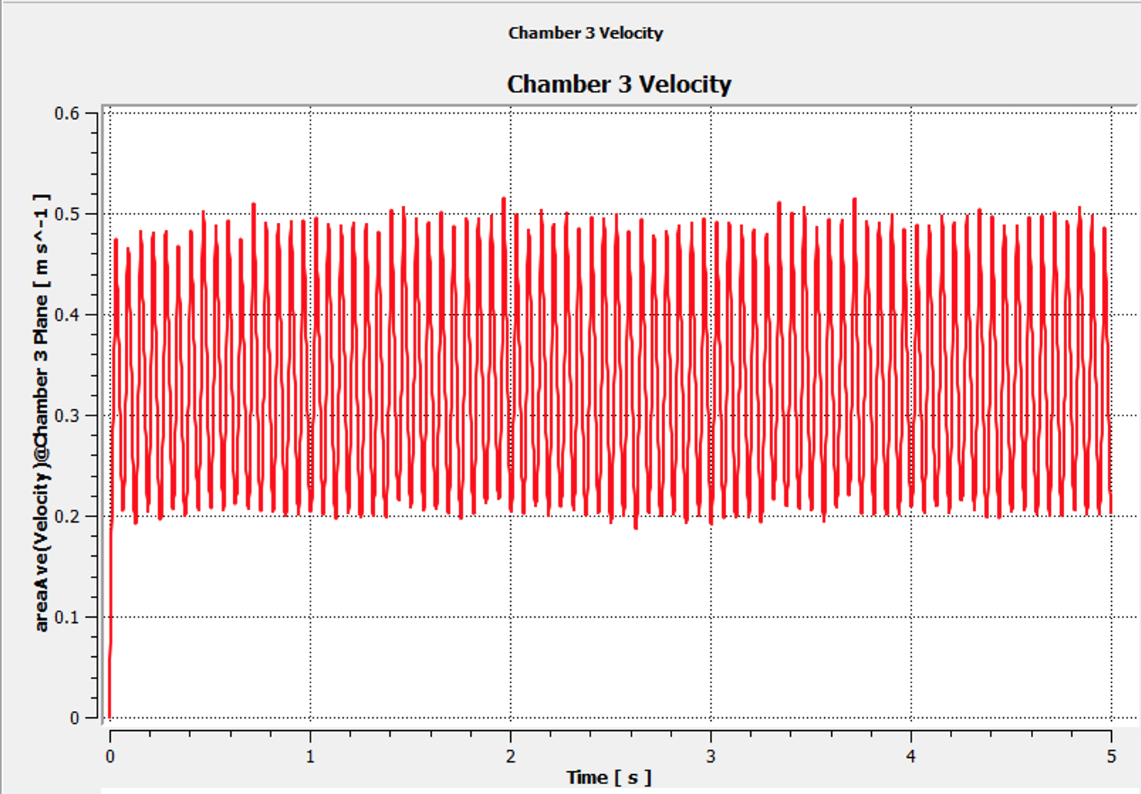

"Calculating Sequence Chart" is taking up to an hour for each chart, I then export the data manually to .csv files. I'm using "XY - Transient or Sequence" charts. When you say use xy charts in FLUENT, what is it that you mean? Is it more efficient to set up the xy charts in the setup, solution or results part of FLUENT?
Then my charts are finally produced, this is how they look:

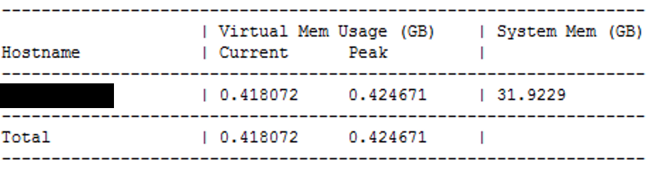

Typing "report/system/sys-stats" returns:

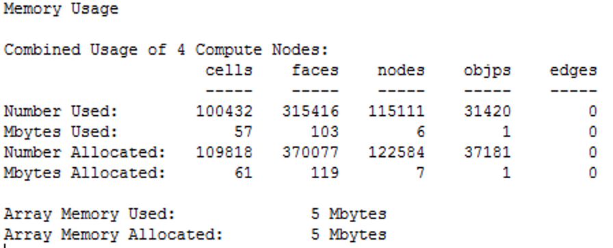

Checking the Mesh Memory I get:

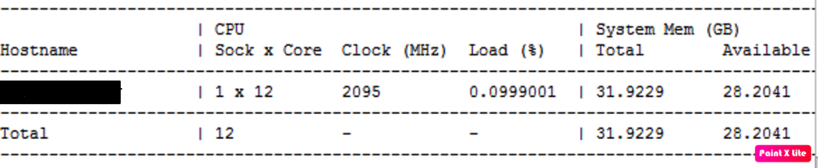

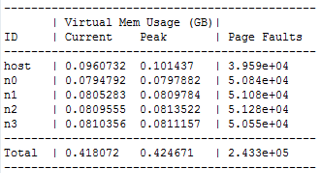

And typing the "report/system/proc-stats" command I get:
This information is all from the server. The number of cells were 98220 elements and 111440 nodes. So in future would you recommend producing the charts in Setup of Ansys Fluent (just referring to Ansys Fluent is too confusing as there are too many aspects of FLUENT, we have Geometry, Mesh, Setup and Solution).
