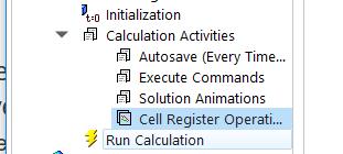

      Figure 1. Calculation Activity location on the tree outline

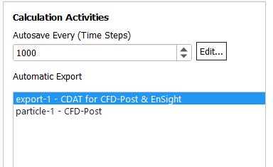

      Figure 3. Exported variables that I choose for post CFD.

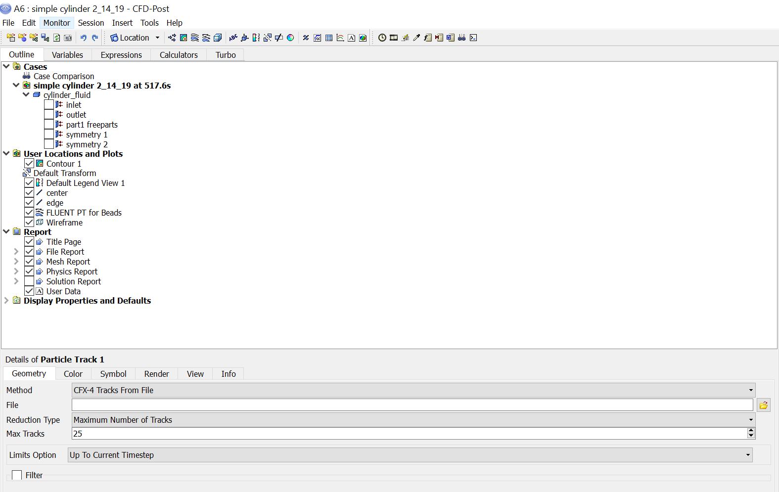

      Based on figures 1-4 I show where I export variables from and that there are variables selected. For the variables in figure 4, these variables don't show up as options to plot in post CFD. Is it because its a default.xml file so they aren't for post CFD? How would I be able to get information such as particle residence time and time steps as options to plot in post CFD(as in the post CFD results cell below)?

      This is a different question. Im trying to get my particle data default.xml files imported into the results (which it does import). But when I want to do particle track it gives me a method of CFX-4 tracks, and the file is empty.
      it
    • Keyur Kanade
      in image above i can see green tick mark for geometry, mesh and setup. but not of solution. you should have green tick mark for solution once you run it.
