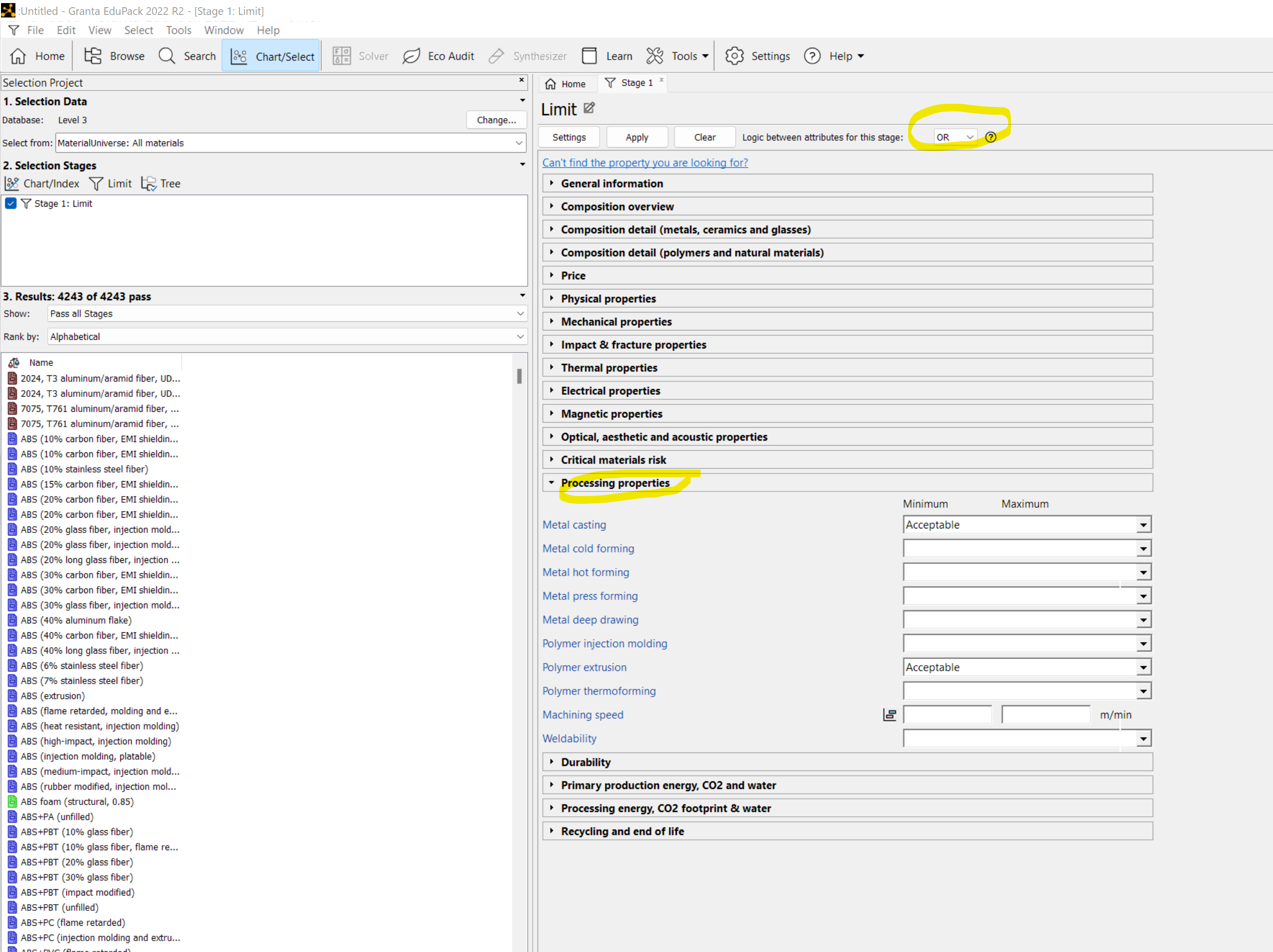

      I have found a very interesting case study regarding a car panel door, however I do not know how, during my selection, specify that the materials can be either molded or thermoformed or deep drawn ? I tried using trees with + and * and it did not work. I tried using limits, but did not find any "OR" sign

      I use the software that ANSYS acquired a few years ago from grantadesign: CES EduPack.
    • David Mercier
      Hi, it is in the 'Limit' step when you describe the processing properties, like given in this screenshot below. It has been introduced in 2022 in the Granta softwares.
