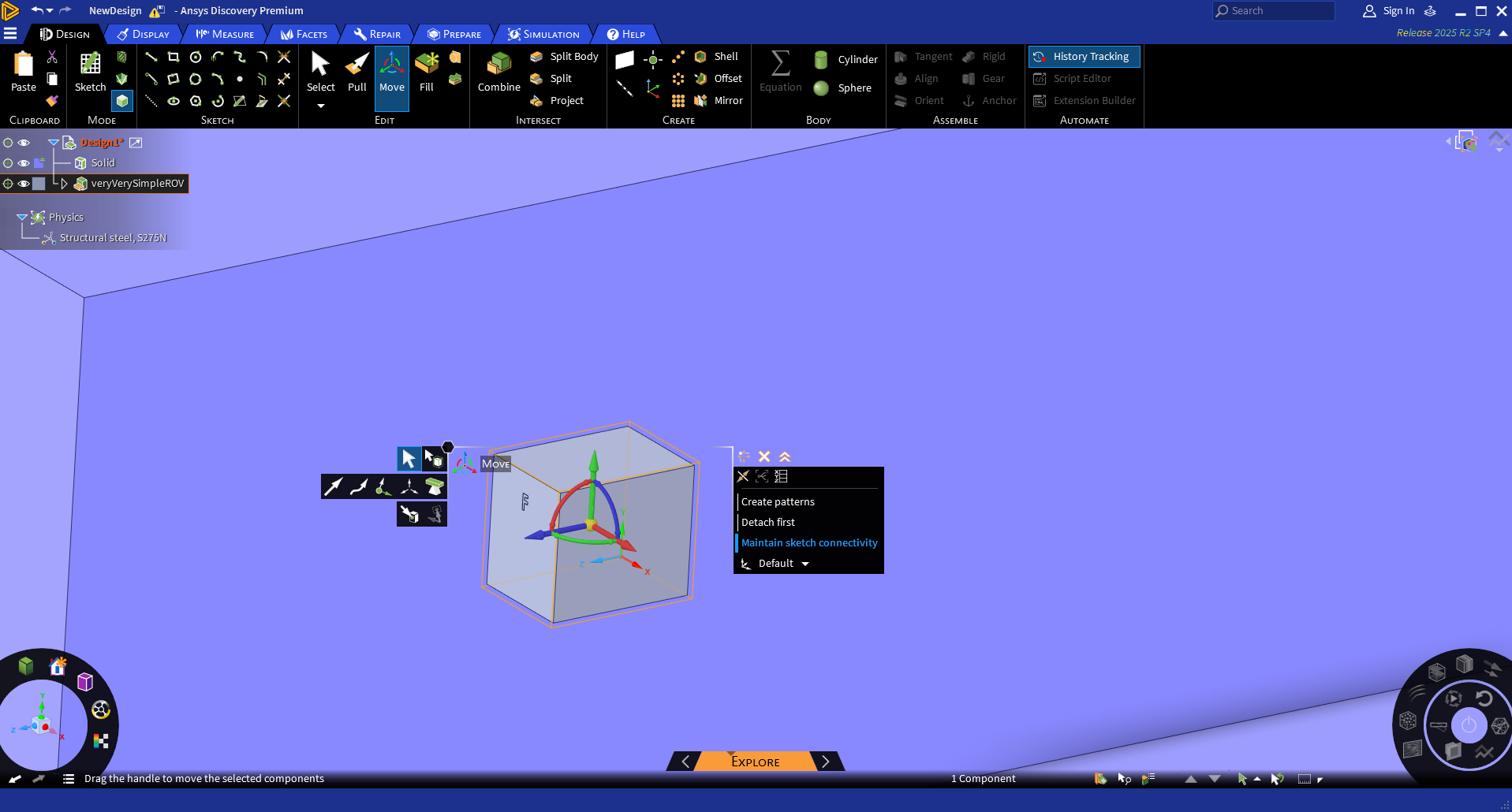

      I am currently: selecting the ROV body/component in the left tree, I click Move, the move tool then shows a triad/axis at the body center of the ROV, I then click the green rotation arc (yaw about Y). I see a small icon for geometric parameterization, but it is always grayed out. I've seen in one of the Ansys geometric parameters tutorials to use the Ruler tool to create some sort of ruler dimension, but I'm not finding any success. It says to click the axis of motion you want, then to select some reference. I've tried to select different parts of the fluid enclosure (that should stay static throughout) but it doesn't seem to do anything.

    • Devendra Badgujar
      Thanks for the details. I would recommend another way of creating parameters in Discovery i.e using History tracking.
      Move angle creation using History tracking is simple and you can easiely modify and iterate multiple designs.
      History Tracking — Part 3 | ANSYS Innovation Courses
