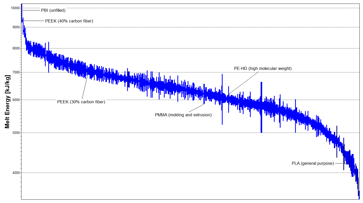

I am trying to plot the following two parameters for all metals, plastics, and composites in the Granta EduPack database:
1) Energy required to melt [kJ/kg] = 8.4*Cp*Tm, where Cp and Tm are specific heat and melting temperature;
2) Energy required to deform [kJ/kg] = 3*(sigma_y + sigma_uts)/density, where sigma_y and sigma_uts are yield and failure strengths
Currently I am able to make 1D charts of these parameters for each material class. Below I show the two plots for all plastics in the database.

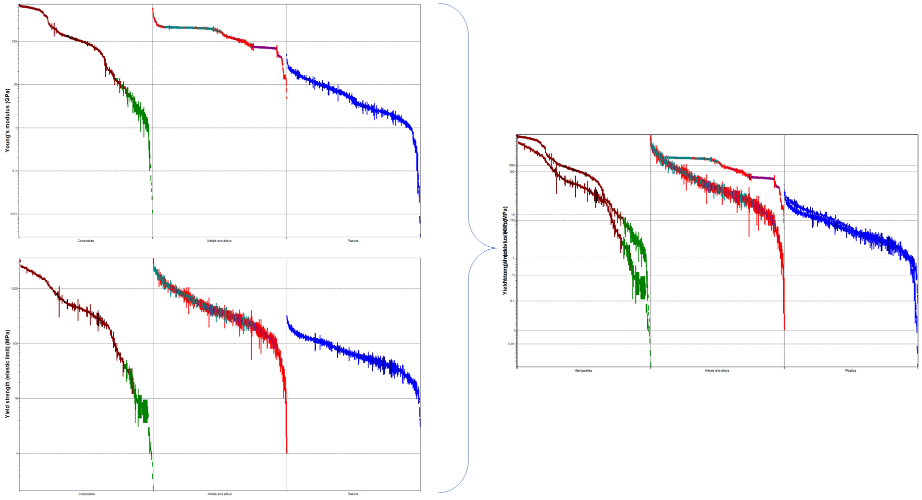

August 18, 2021 at 3:29 pmWZhao
SubscriberHello, there,
There is a trick I have used a couple of times for your reference:
Create both charts in edupack with the scales adjusted
Copy both into PowerPoint, set the background to transparent
Overlapping two charts together
I have create a quick example (without aligning scales though, just to show the idea):
Hope this could be of some help.

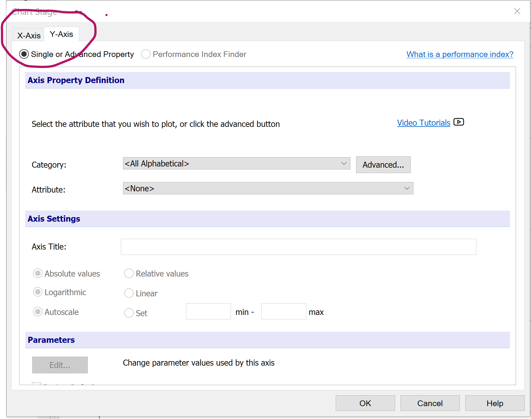

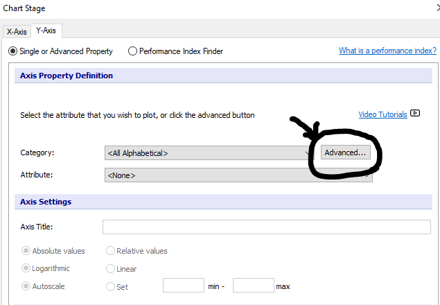

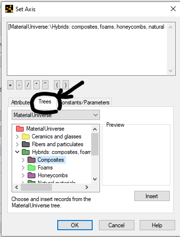

August 19, 2021 at 10:09 amWZhao
SubscriberHi You are right about the scales. This is what I have done so far.
As to add different material class on x-axis, I used the Advanced under Chart:
(BTW, the axis setting down there is where I set the scales)
And then if you go to Trees:
You are then ready to add whatever material class you would like to. I am guessing until now you should be able to create the individual charts as the way you like them.
August 30, 2021 at 2:28 pmDavid Mercier
Ansys EmployeeHi, to get such graphic it is explained above by defining material families you want to show in the tree option of x-axis. And for the y axis limits (min and max, it depends if you show 1 or 2 axis on your graphic. If you keep 1 axis, you have to set the same max and min values for the y-axis. If not it doesn't matter but you have to play on the color for example to differentiate the 2 different plots (eg Young's modulus and Yield strength).
