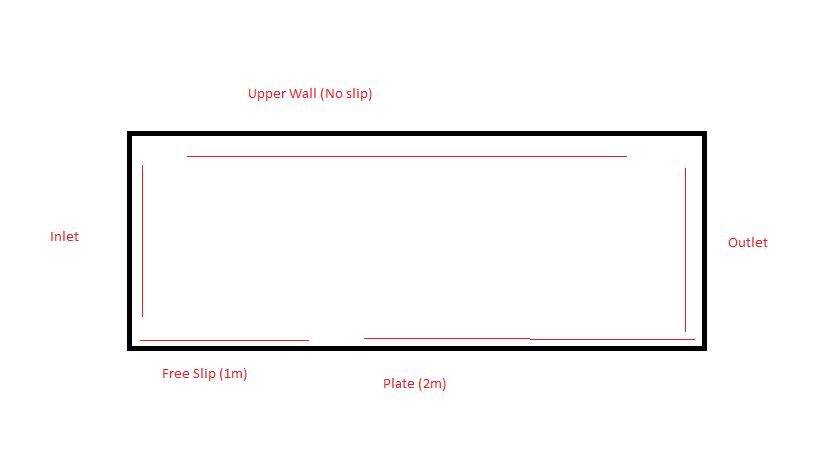

    • AbhayCharan
      Sir, I want to calculate the skin friction coefficient of a flat plate by injecting air bubbles at 10% of the length of the plate at a velocity of 0.1 m/s at Fr no. 0.2.
      Also the diametre of the bubbles is to be 50 um. The outer flow is of sea water.
      Request to know which model is best suited and how do i go about it.

      Sir, Currently Im stuck in validation of a 2 D flat plate. The shape of the Cf vs. Re plot for Re at 1x10e6, 2.5x10e6, 5x10e6, 7.5x10e6, 1x10e7, 2.5x10e7, is following a upward trend. where as the paper im refering to, follows a downward trend. Request to know if there is a better way to validate a 2D flat plate turbulent flow.
      https://www.grc.nasa.gov/www/wind/valid/fpturb/fpturb02/fpturb02.html This is the paper in trying to validate.

      Sir,
      I am trying to prove the reduction in the skin friction coefficient of a flat plate. The normal value of the skin friction resistance of a 2m flat plate at a reynold number of 31000 is 0.00245, (validated using David Eaton's paper on "The reynold number scaling of a flat plate), Velocity of water : 0.027m/s.
      Now I want to reduce the drag by injection microbubbles.
      For that, i used the same domain, Intel (velocity inlet), Outlet (pressure), Upper wall (Wall), initial free slip, and then the plate. (1m free slip, 2m plate, ht of domain was 1m).
      I used VOF method, Descrete Phase : ON. Implict. Injection :  single, at a location of 1.2m, at 0.01m/s, Flow rate of 0.001m/s. diameter of bubbles as 0.00001m, stop time as 100s.
      Im using k-omega model.
      Phase 1 : Water
      Phase 2 : Air
      But my Skin Friction Coefficient has increased to 0.075.
      Request to know where my mistake is.
      Request for urgent help sir.
      Thank you sir.
    • AbhayCharan
      Boundary conditions
    • AbhayCharan
      Also, any change i make in the injection setting is not reflected in the solution.
      It is my sincere request if you could help me identify my problems.
      Thank you.
