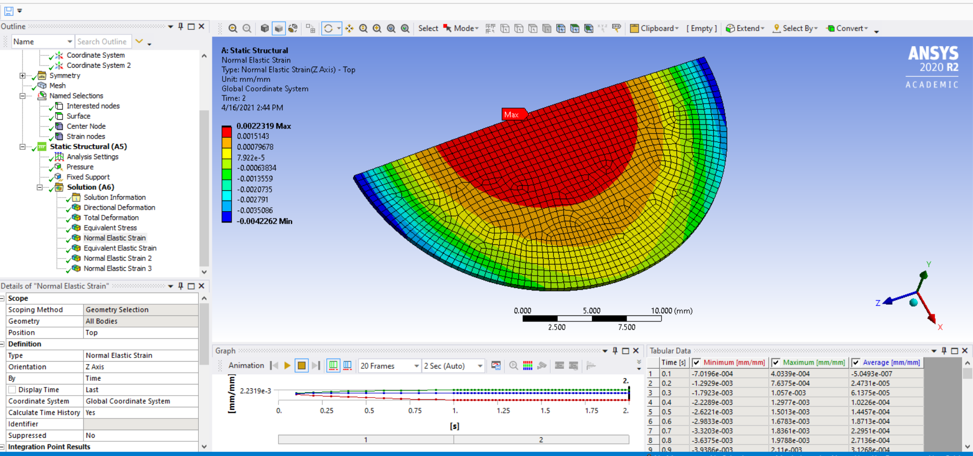

      I'm trying to plot the local biaxial strain (radial strain) on the top of the plate. The idea is to measure the displacement gradient along the center nodes. The geometry is symmetric.nWhat I was thinking was to export the normal elastic strain in the x and z-axis and find the magnitude. However, the geometry is still in the cartesian coordinates. nIs there a better way to go about this? Thanks for your help.nnn
      nCreate a Cylindrical Coordinate System. Make the Z axis of this coordinate system go along the Global Y axis. Make the X axis go along the global X axis.nNow create a Normal Strain plot using that new coordinate system. The X axis of that is Radial.n
