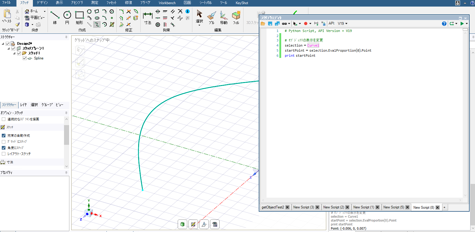

      As you can see in the image, I wanted to know the starting point of Spline so I could get it.
      However, the Curve1 of the slection was obtained by recording the script editor.
      Is there a way to write this SketchCurveVariableWrapper variable to get it without using record mode?

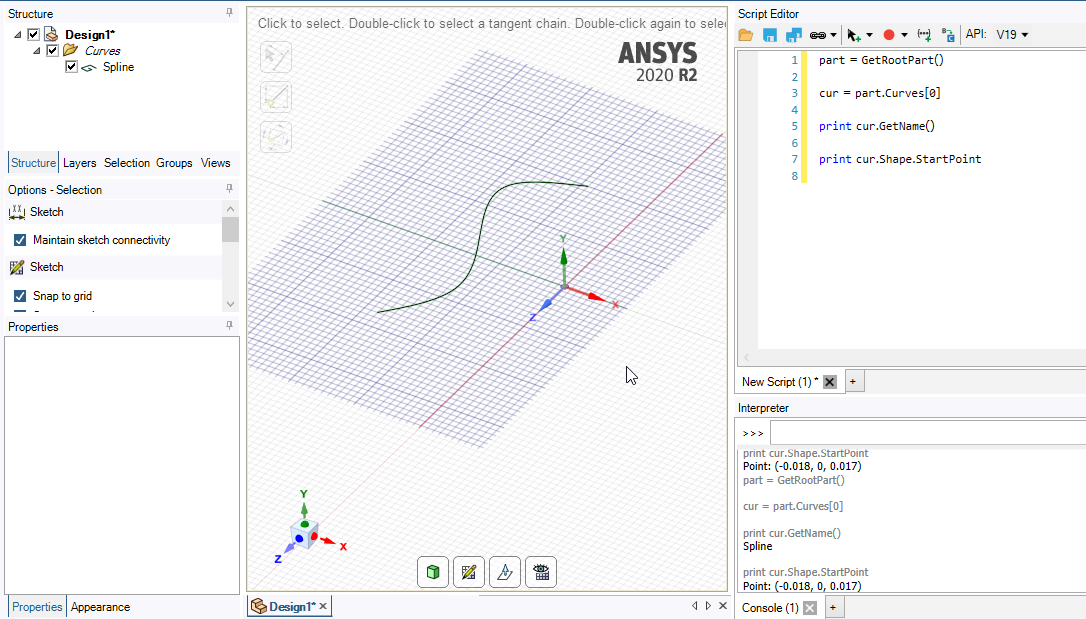

      See below snapshot showing the code to access the curve and its start point. Let me know if this is what you are looking for.
