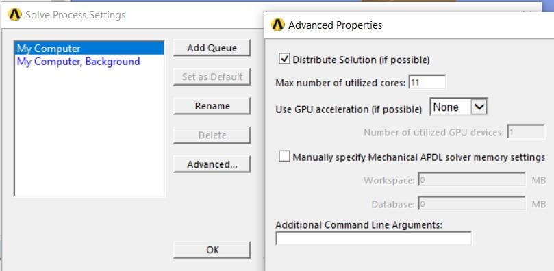

SubscriberHow do I launch in parallel
December 20, 2019 at 12:13 pm
peteroznewman
SubscriberIf you mean you are using Mechanical Workbench, then in Mechanical, you go to Tool, Solve Process Settings... click the Advanced button and type in 11 for Number of Cores. I have run the same model with different number of cores and there are diminishing returns as the core count goes up, especially if you have large contact areas. For example, going from 2 to 4 cores might solve in 60% of the time of 2 cores, then going from 4 cores to 8 cores might solve in 75% of the time of 4 cores. Different models will scale differently. Using every core can be slower than using one less as rwoolhou said.
If you get an error when you try to solve with 11 cores, try using 10 cores. I don't recall the number of cores 19.2 allowed without HPC, it may have been 4 or 2. An HPC Pack adds 8 cores to the base number. If you can't solve with 6 cores, then there is a license issue. Are you sharing the license with other users? In that case, someone else might be using the license. There are ways to check this.
