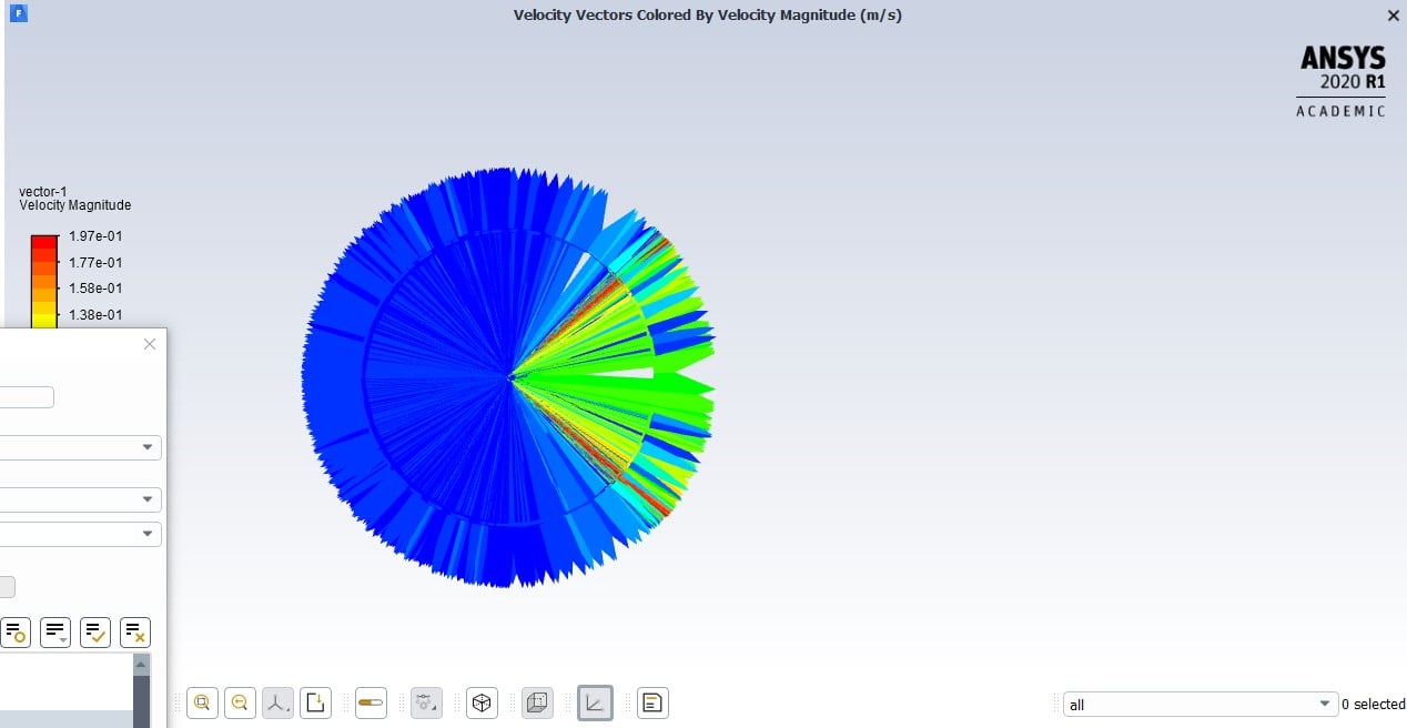

How do I format the velocity vectors to not be sized by magnitude?
    • curlerdude
      I want all vectors to be the same size, just coloured by magnitude, as they currently are.  See picture.

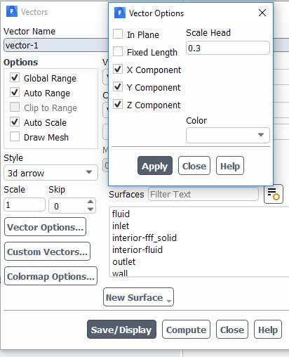

    • Keyur Kanade
      please use vector options -- fixed length.

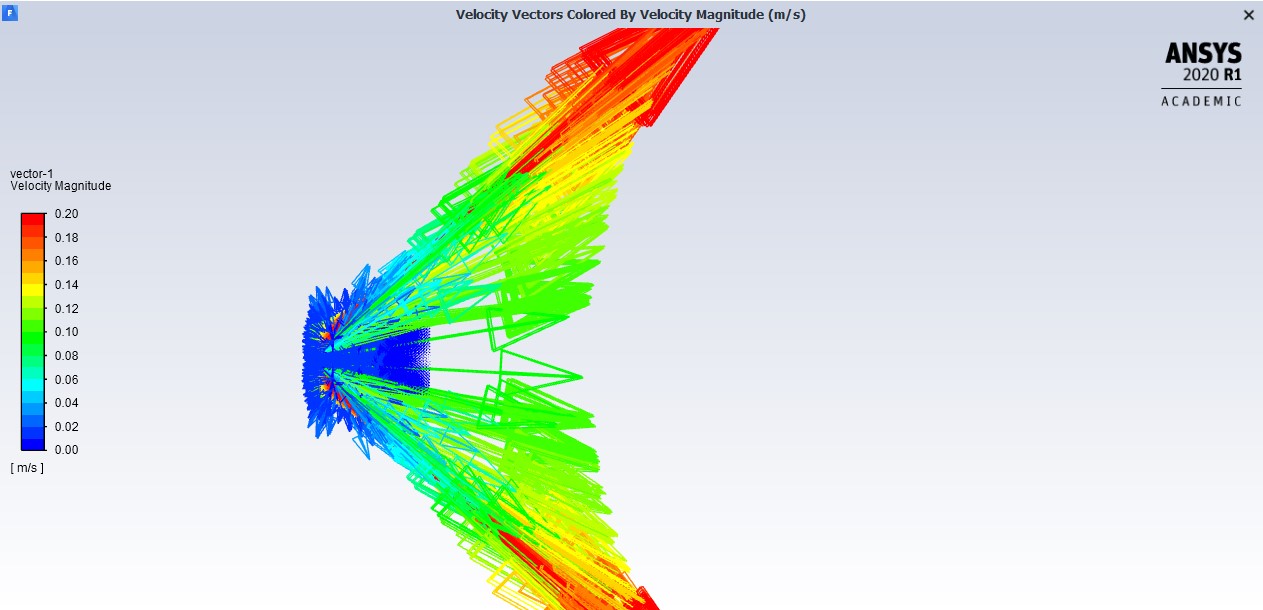

    • curlerdude
      Thank you, but that makes all the vectors the same size as the largest one (see picture).  Is there a way to set the sizing, and if so what is the scale for this measurement?
    • Keyur Kanade
      use scale option.
