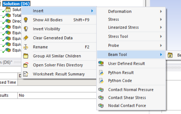

Under Output Controls in "Analysis Settings", ensure that Strain is set to Yes. After running the simulation, you can find the strain components including principal strains from the Worksheet object in the Solution toolbar.

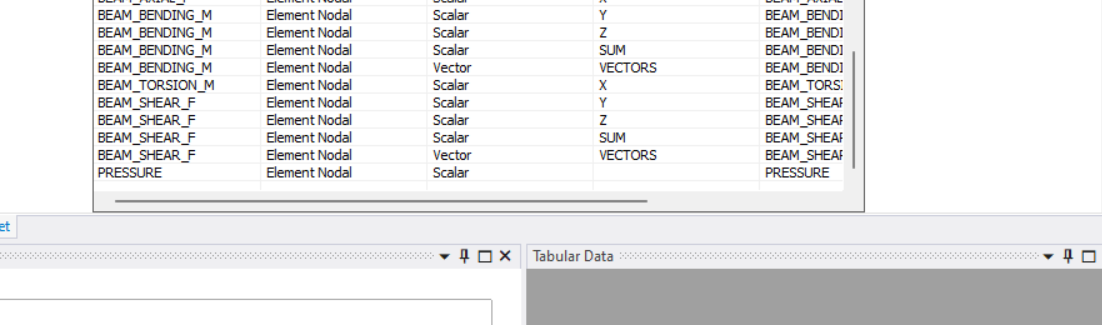

Stain is already “Yes” under “Analysis Settings”. Don't know why it' not coming up.

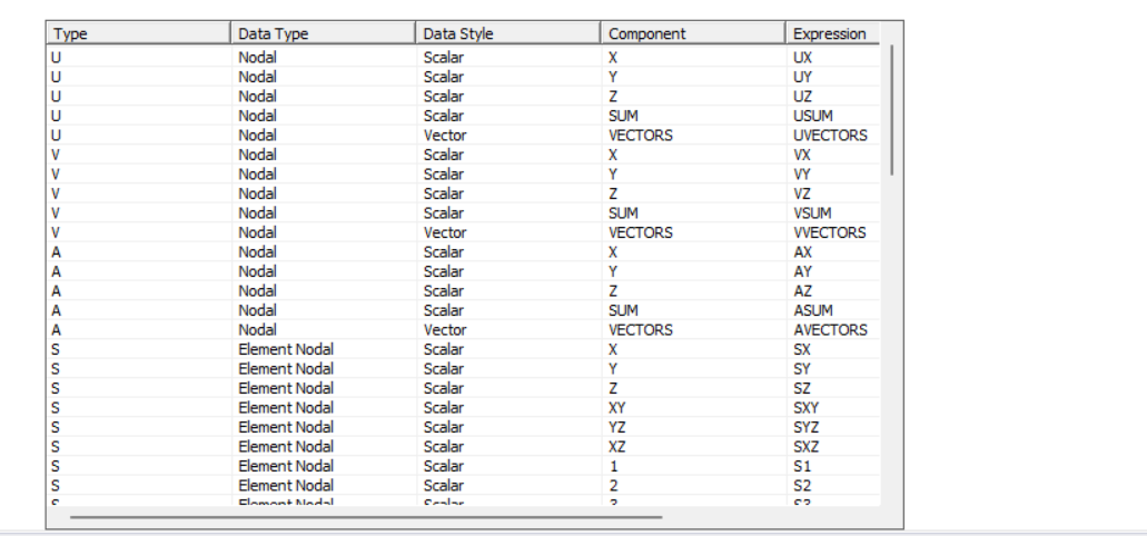

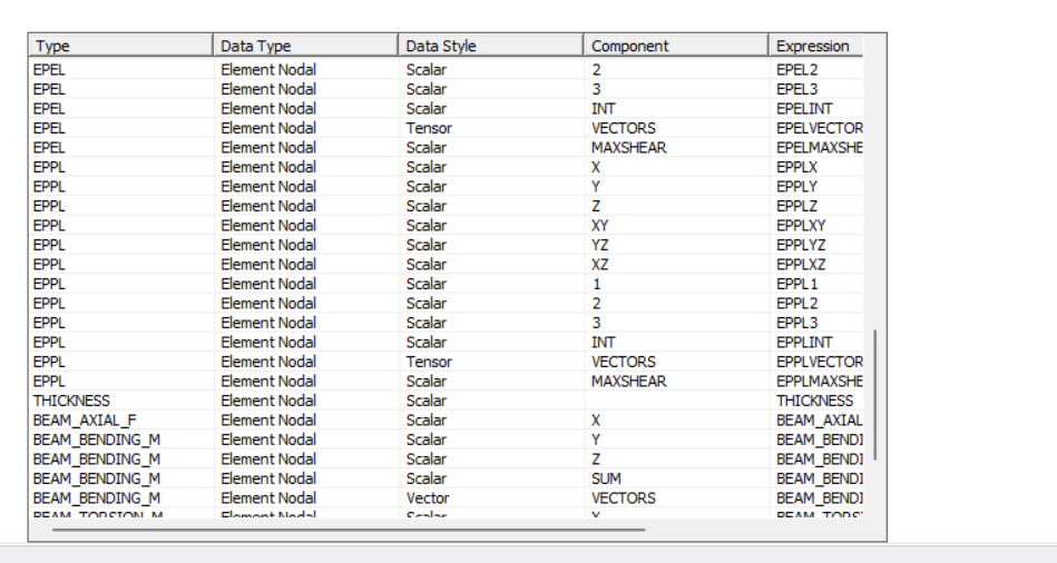

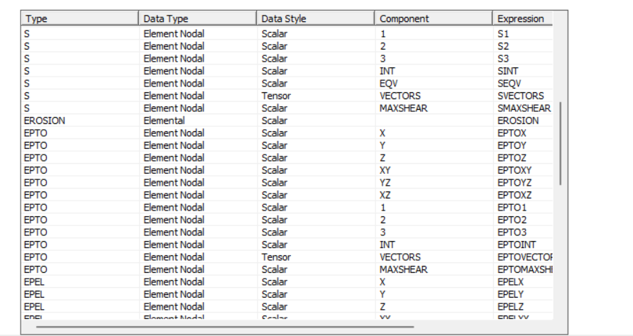

Ansys EmployeeLooks good. For the type indicated as "EPTO", the ones shown with 1, 2, 3 (Component column) are the principal logarithmic total strains. So just right-click on these three values, and request it to be plotted for your model.
May 12, 2023 at 2:26 pm
Ben_Ben
SubscriberThank you so much Armin! It works!! What does component 1,2,3 mean?
May 12, 2023 at 2:29 pm
Armin
Ansys EmployeeNo problem Ben.
We have three principal stresses, so these are the first, second, and third principal stresses, respectively.
