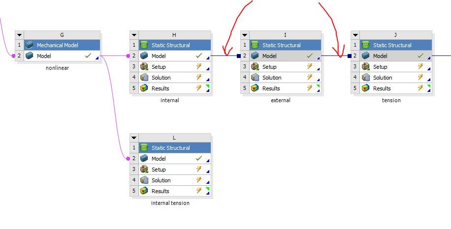

How do I change the type of links from SHARE to TRANSFER DEFAULT DATA
TAGGED:
    • sombodyfromtheworld
      I want to break the SHARE type of those two links indicated with red arrows, see picturenIs it possible to separate them similar to L environment, see picturenn n
    • Govindan Nagappan
      ArraynYou cannot change the type on existing system. You can create a new system and transfer data from system H.nTransfer: Drag and drop a new static structural system in the project schematic. Then drag the Model cell from system H to the model cell of the new system. This should transfer the datanShare: Drag and drop a new static structural system on Model cell of system H to share datan
      hinif i do this -Transfer:Drag and drop a new static structural system in the project schematic. Then drag the Model cell from system H to the model cell of the new system.ni have to create new loads and boundary conditions, correct?n
    • Govindan Nagappan
      Yes, if you use a new system, only the model is transferred. So, you will have to define loads and BC's in the new systemn
