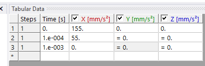

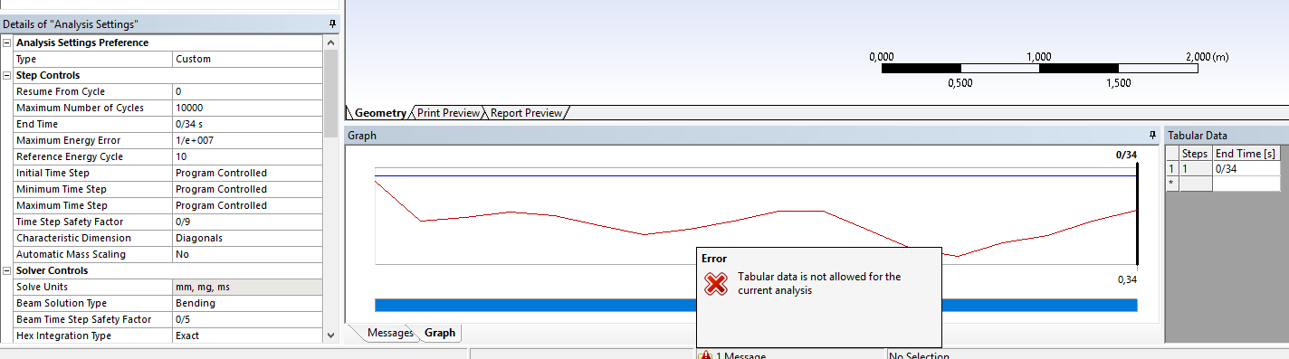

SubscriberYou are right.nIn the explicit analysis of Ansys19, it's not possible to apply acceleration in a tabular data. Is it the same in other versions? And whether this acceleration must apply to the center of mass in structure or not? How can I apply acceleration for 30 seconds in different steps?nThank you for your attentionnn
