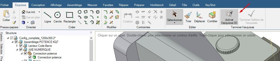

    • vincent.rouillot
      Thank for your answer, but unfortunatly I need to understand the fonction in the tool bar.

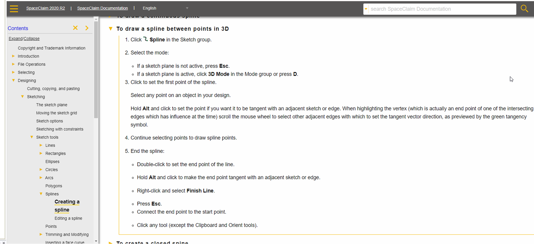

    • Naresh Patre
      Hello Vincent Rouillot I have created a short video showing how to use the "Enable 3D sketch" tool and create a 3D spline. Please find this video attached. You can also find some information on drawing a spline between points in 3D in the help document as shown below:
