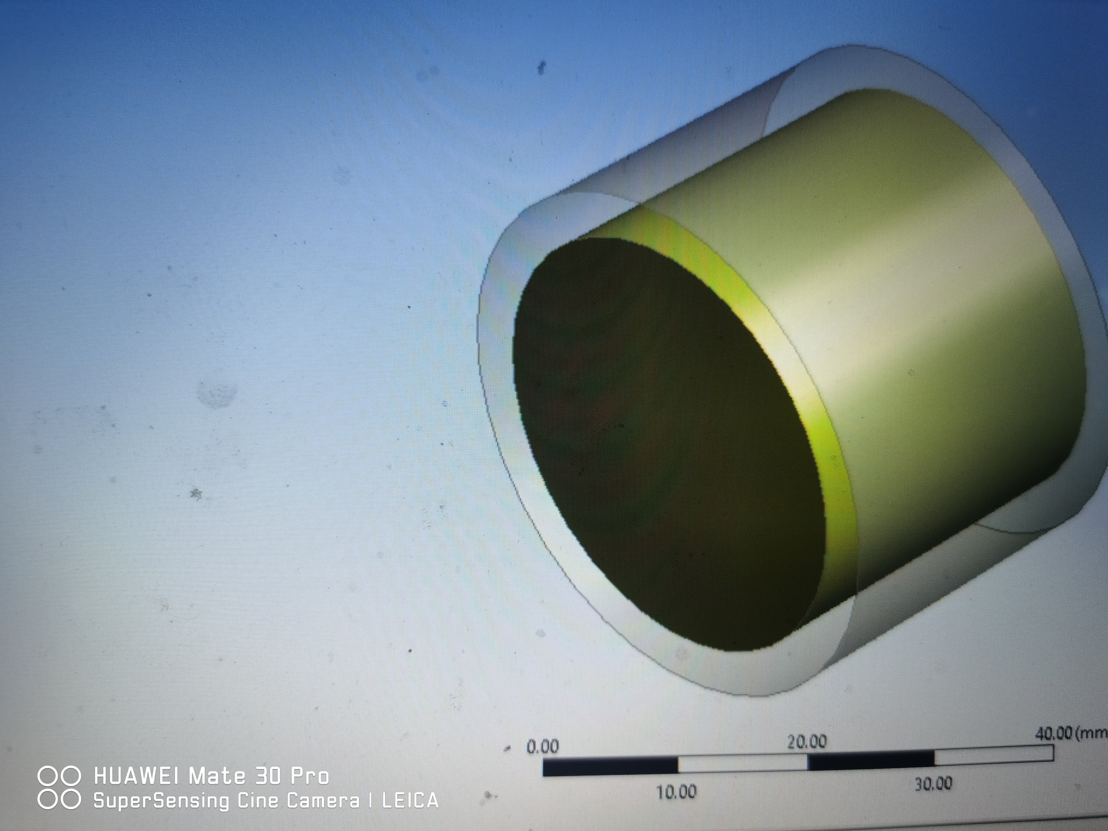

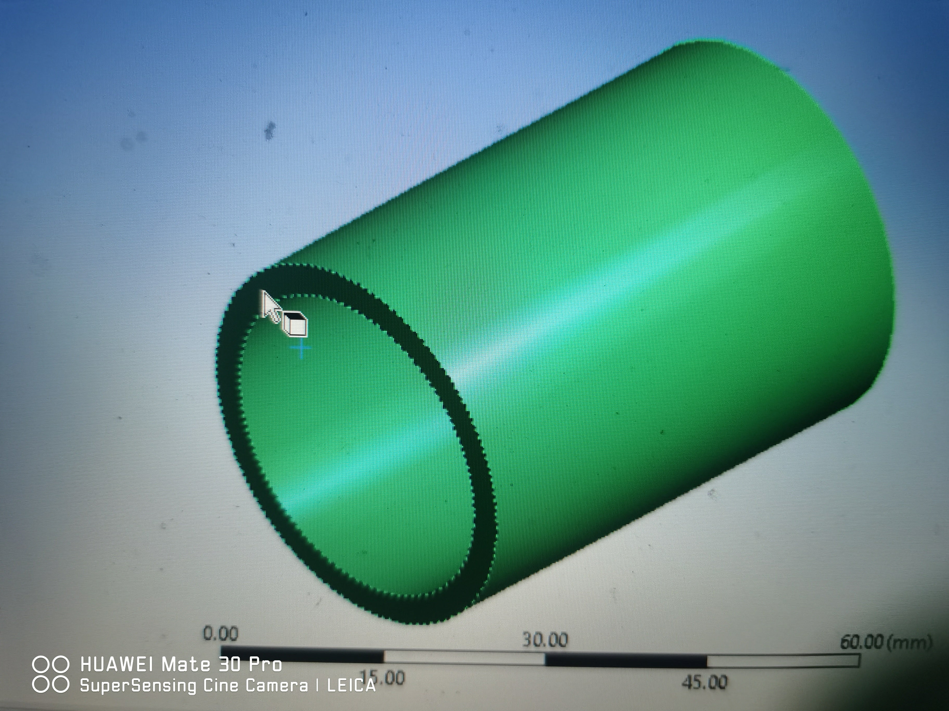

      I have evacuated tube solar collector . The evacuated tube consists of two tubes, one external and the other internal. The tubes are made of borosilicate. The first tube is transparent, while the second tube is covered with a solar absorbent material.
      There is a space between the two tubes to avoid wasting the energy gained in the second tube.
      How we will apply a mesh to the region between two tube that is a vacuum. how to model thermal radiation in ANSYS. if temperature at a surface is 500 degree celcius and the other surface is at 20 degree. there is a vacuum between two surfaces . how we will mesh the region between two boundaries

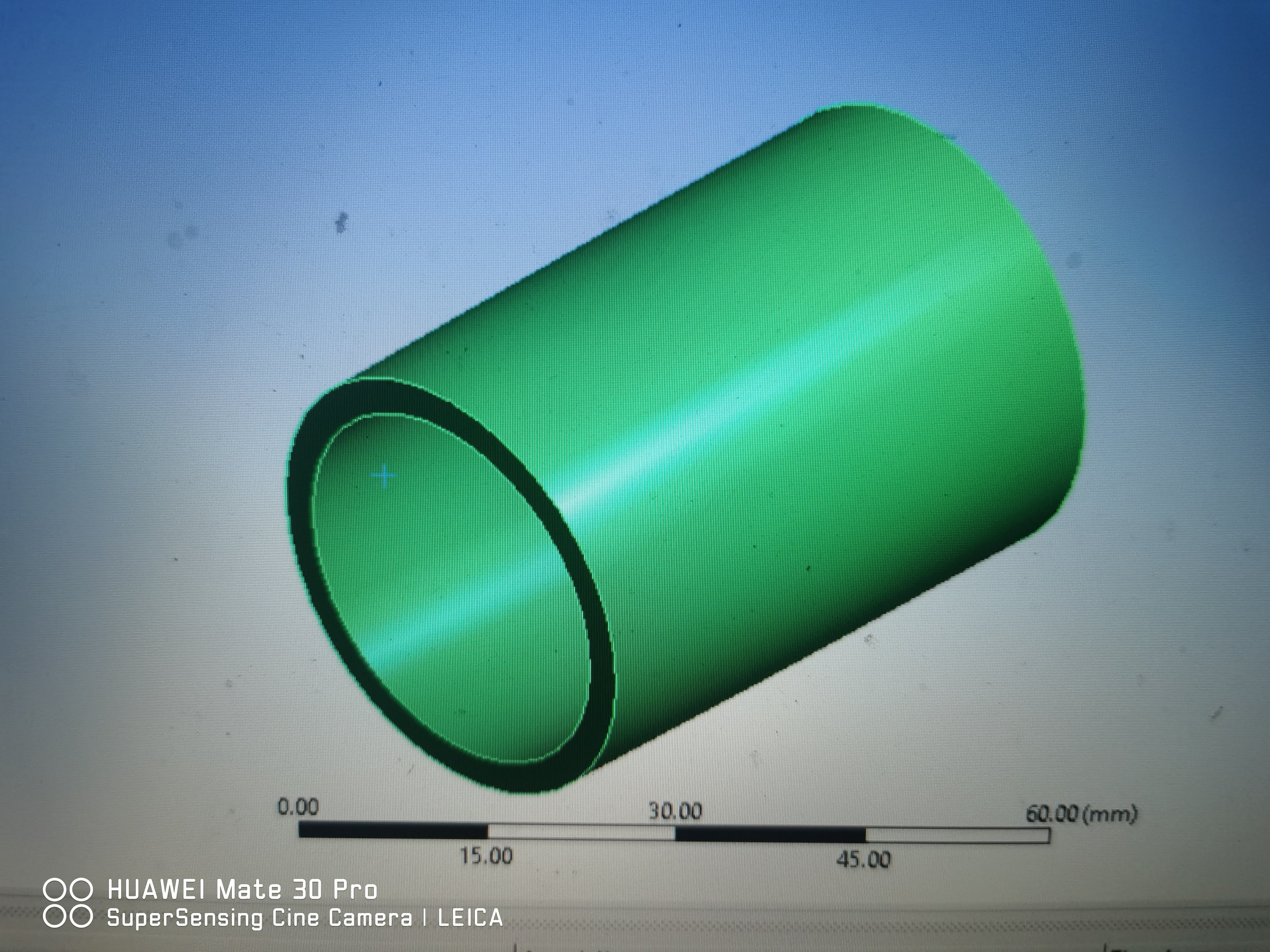

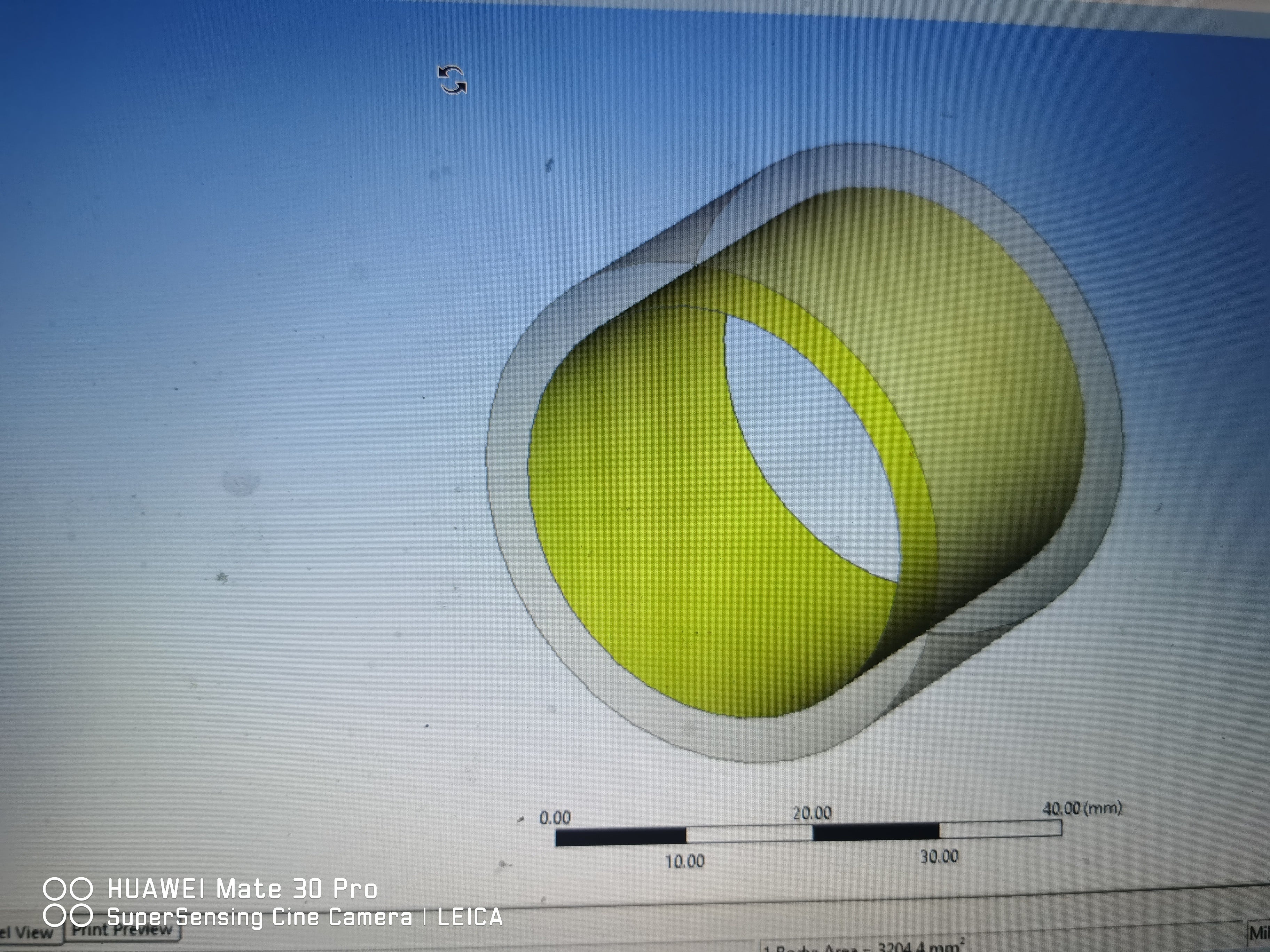

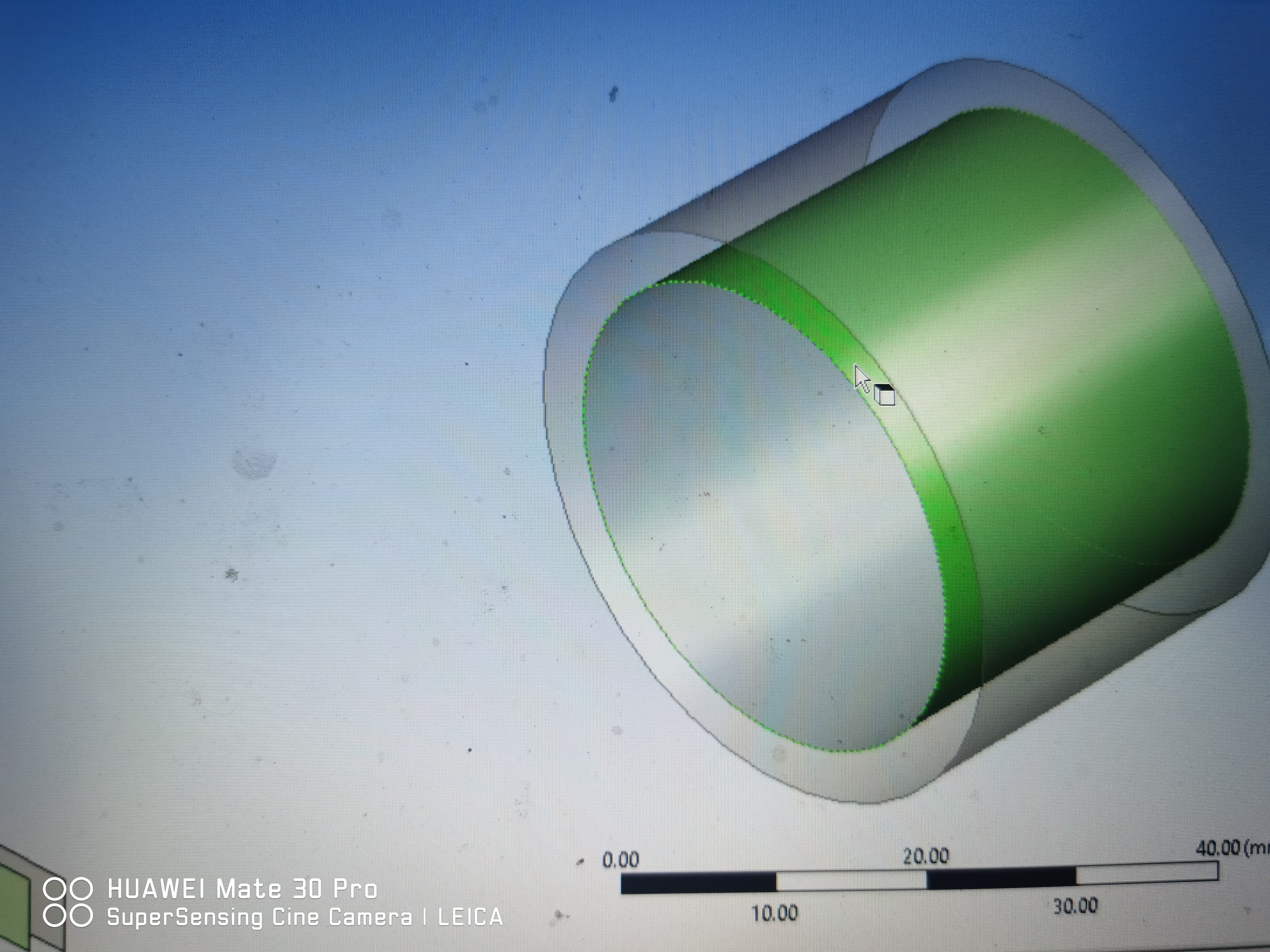

      The geometry is attached below
      When I draw tubes, the space between tubes is always solid. I want to make it vacuum. How can I do this process?
      Thanks for your time
      In SpaceClaim, on the Design tab, use the Select button and click on the inner face of the tube, hold the Ctrl key down and click on the outer face of the tube. Keyboard Ctrl-C and then Ctrl-V to execute a Copy/Paste. Now you will have two surfaces. Delete the solid.

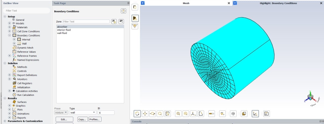

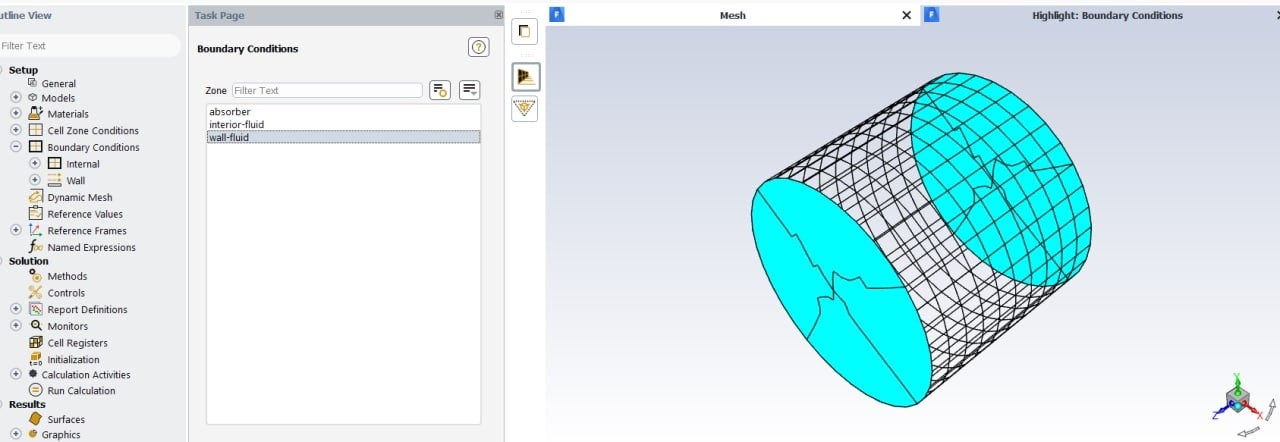

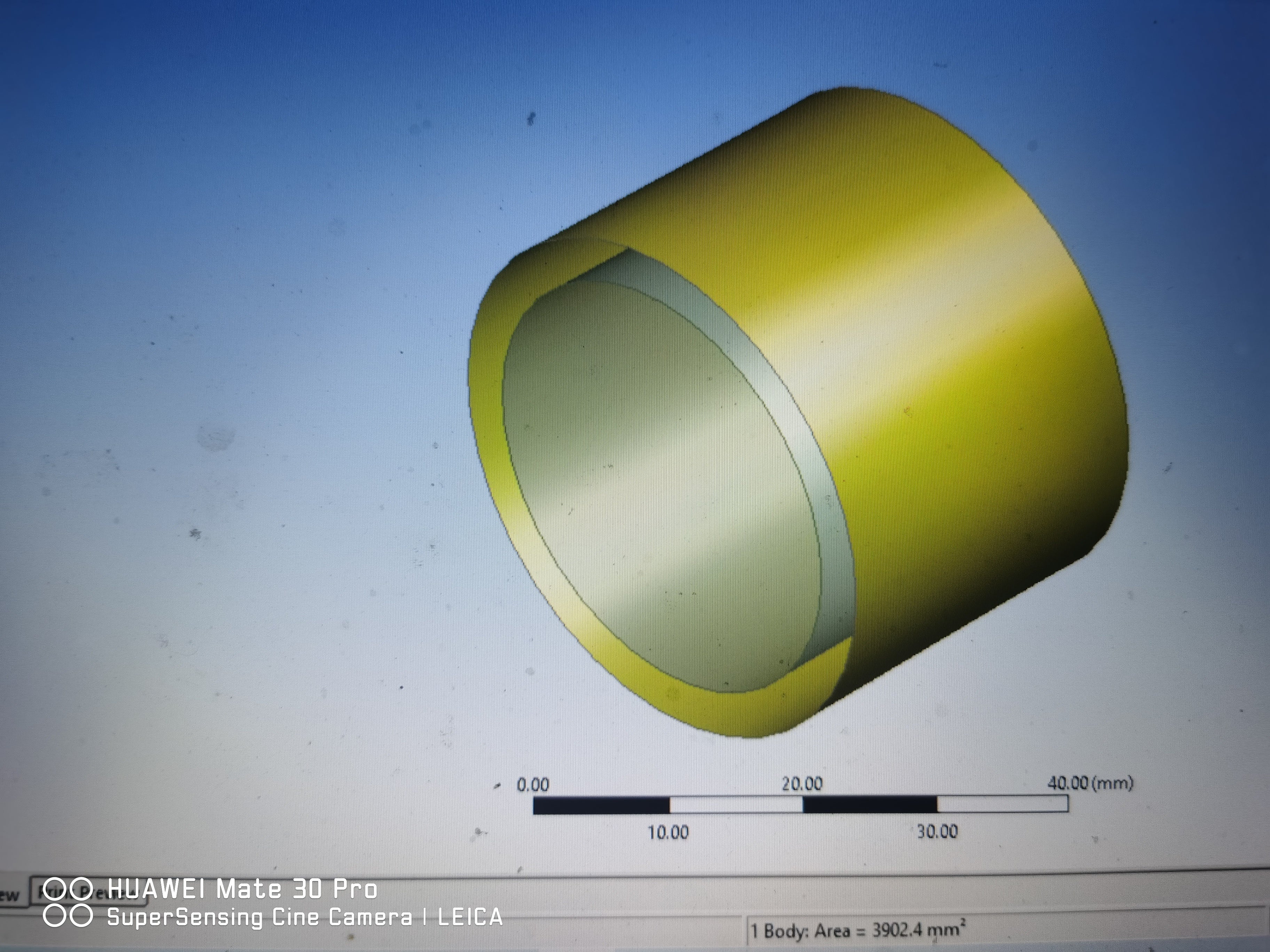

      Hello
      I made two surfaces as you advised me. When applying boundary conditions, the outer surface did not appear. Do you know why ?
      Please use Windows Snipping Tool or the new Snip & Sketch to get screen images to paste into your replies. The cell phone jpg images take a long time to download because they have way too many pixels, most of which are wasted.

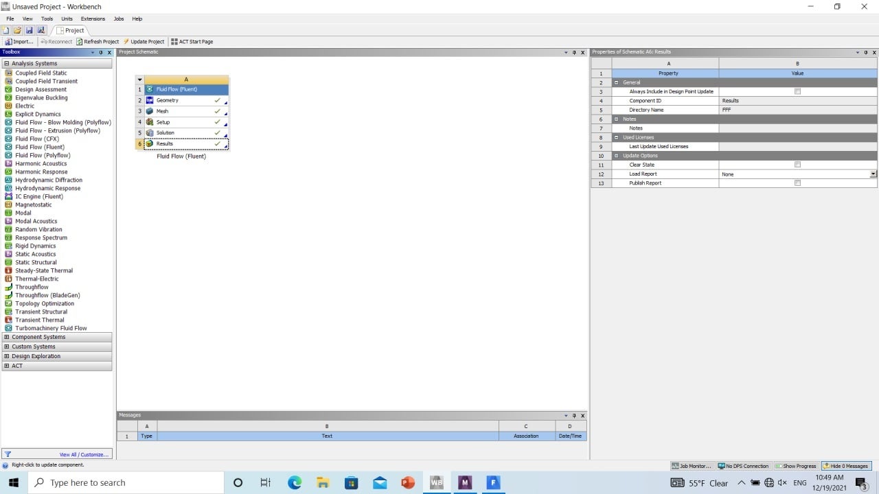

      Do you have Structural solvers like Steady State Thermal analysis or only Fluent?
      What version of ANSYS are you using?
    • Yahyaalkaisi

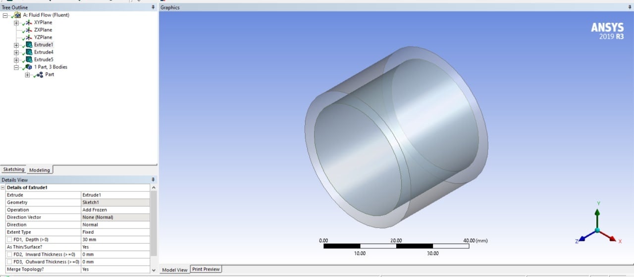

      The version of Ansys are 2019 3R

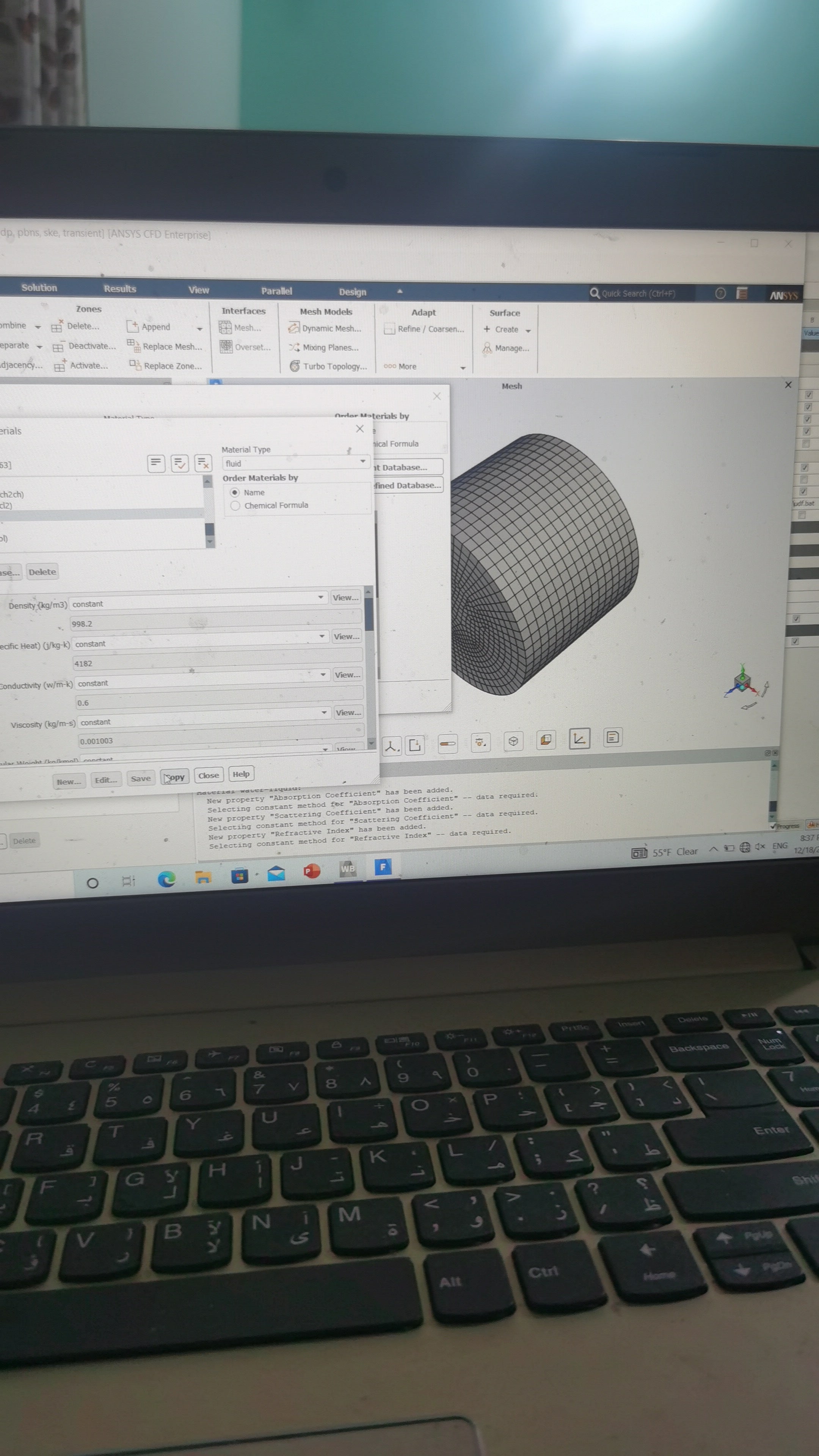

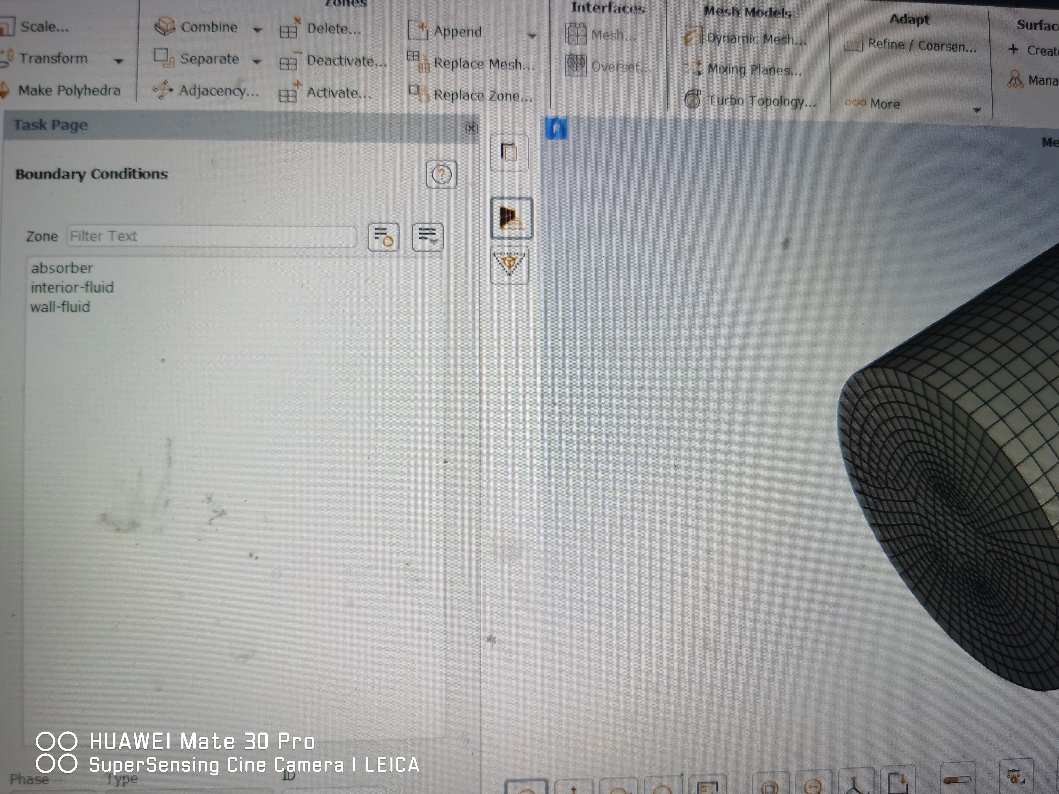

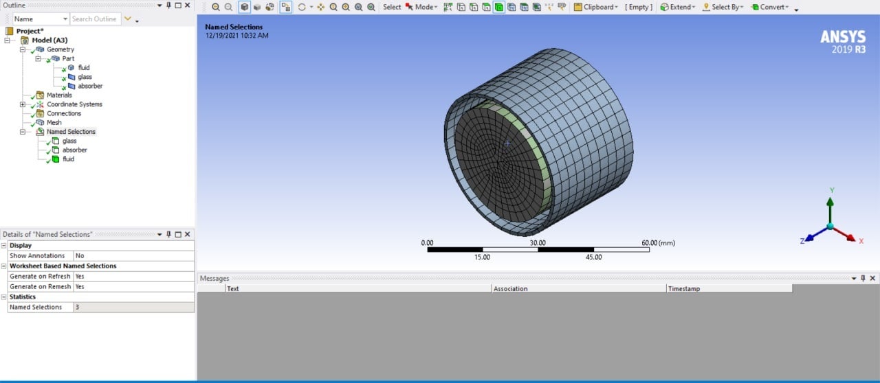

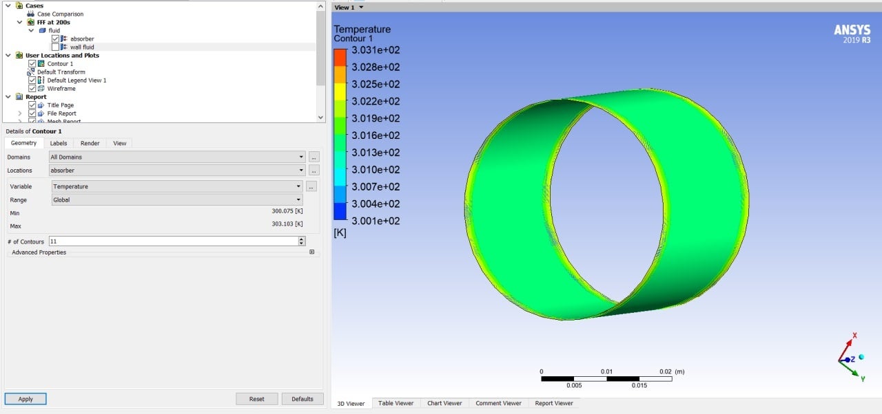

      The solution only for fluid
      The absorber material not appear in results.
      The glass surface not appear in boundary conditions.

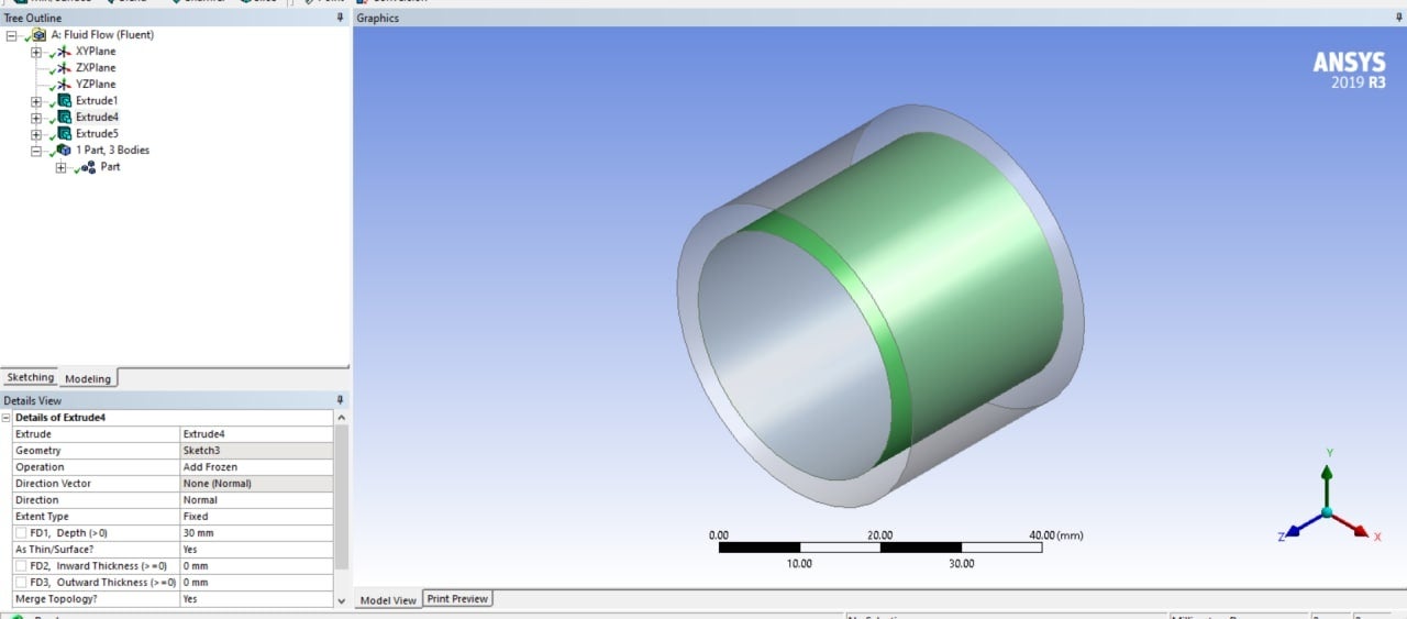

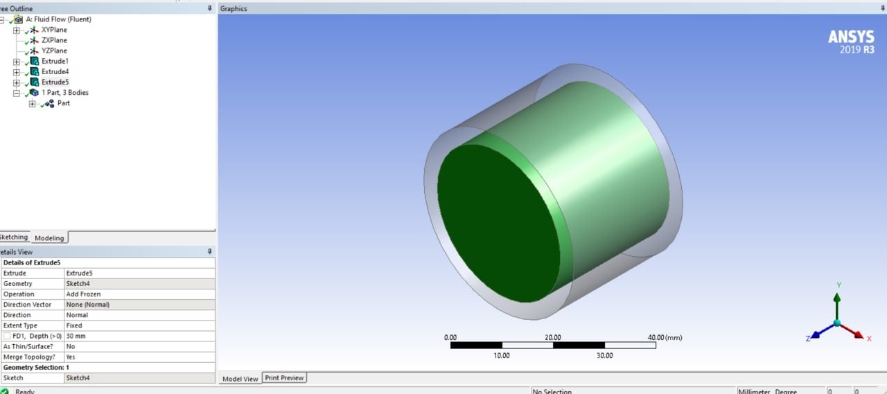

      Open the geometry in DesignModeler. The last item in the Outline shows one Part. Right click on that Part and select Explode from the pop-up menu. Now you will have three parts and three bodies.
      Select the Fluid and Absorber items in the outline, Right Click and select Form New Part from the pop-up menu.
      Bring that into Meshing. You can mark the solid body as fluid, and the two surface bodies as solid.
      See if bringing that into a fresh copy of Fluent gives you what you want.
      Don't use the initial Fluent analysis, because it can be difficult to clean out the old things created from the initial geometry.

      I am drawing both the glass and the absorbent material to a certain thickness and the idea worked.

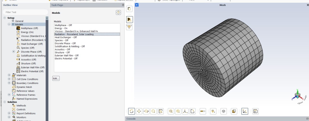

      and others, please is it compulsory I mesh the glass cover?, I'm trying to model using ICEM CFD, I had a previous geometry where I didn't include the glass cover, and the mesh in ICEM CFD was perfect. Thank You, In advance.

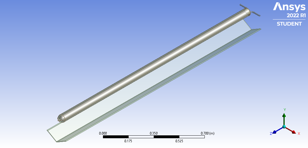

      Can you send your work on my email, I want it as a reference tool for my thesis on Solar Thermal Baking System. and How can I make the Fluent to know the #vacuum in the evacuated tube glass
      and one more thing, is it necessary to draw the V-shape trough to do the analysis in fluent ???

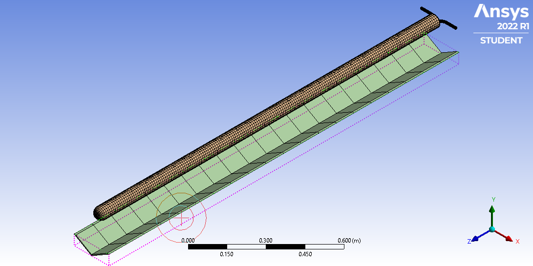

      Its working principle is, the nanofluid enters in the U tube copper tube. This copper tube is inserted on the hole of the evacuated tube glass. The bottom part of this evacuated glass is get additional heat flux by the V-shape concentrator. then the fluid is heated to certain temperature. this temperature is used for cooking purpose. That is it!
      Start a New Discussion that can focus on the specifics of your problem.
      I suggest you draw a diagram of all the heat transfers in a typical cross-section of the system.
      You need the V-shaped trough to have radiation reflected onto the glass tube.
      The glass and copper tubes will transfer heat by conduction.
      The copper tube in the vacuum of the glass tube will only get heat by radiation.
      The fluid will get heat by convection from the copper tube.
