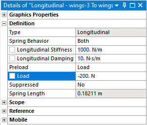

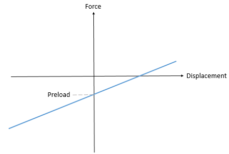

SubscriberI'm working with a model of a car with 4 suspension system in rigid dynamincs and I need to specify a load that indicate the minimun load to start the compression of the spring, this is because the spring-damper system (shock Marzocchi Moto C2R) of the real vehicle has the property to select this number. For example, If I want to specify that the shock start the travel of compression after the driver sits in the car, I have to configure this value in the shock including the load of the sprung mass and the pilot (the quantity of load that affects that wheel), if the load in that wheel is 1000 [N] and the proportion of the load of the driver is 200 [N], I will adjust this value at 1200 [N], and the shock will not compress, but if the car pass throght a bump and the load increases the shock will start to compress.
Thanks!

SubscriberThe preload acts only in the initial state of the analysis, is just an initial condition.
