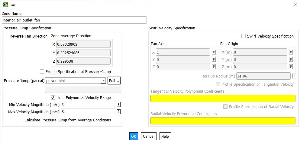

    • Kepojeyathas94
      I've read the fan boundary condition in the user's guide but nothing happens when I put these settings in the fan settings. I've set only the min and max velocity magnitude.
    • Keyur Kanade
      your min and max has very small difference.

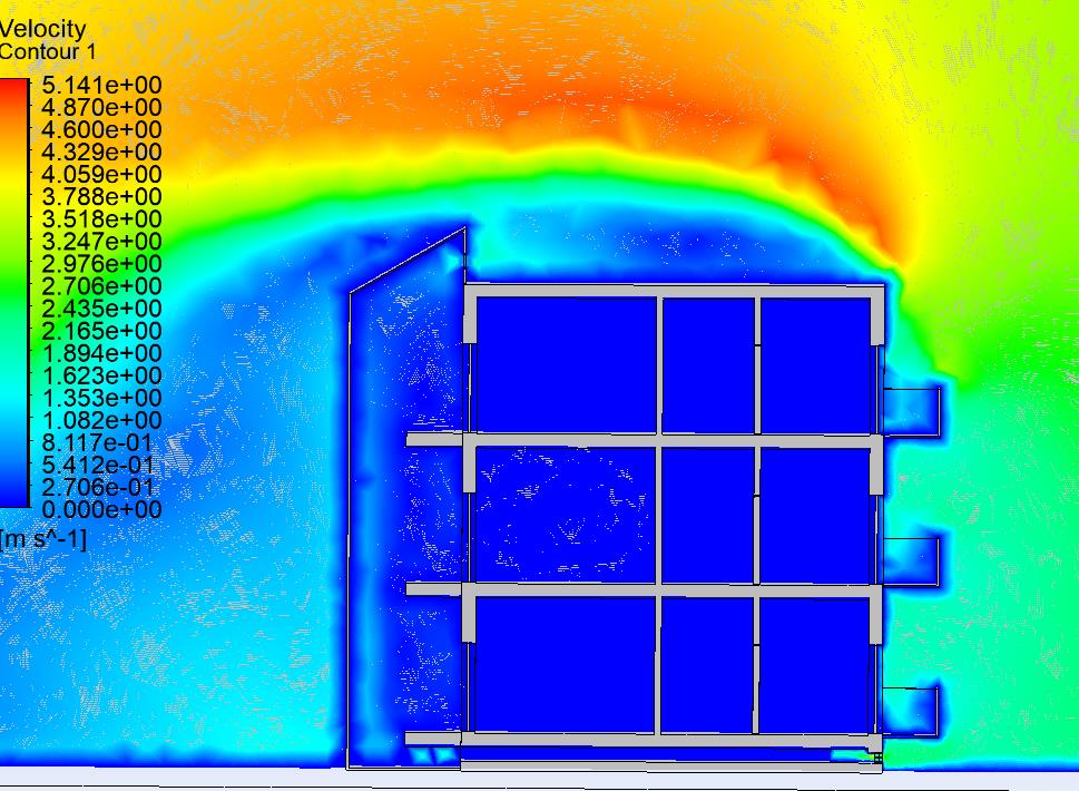

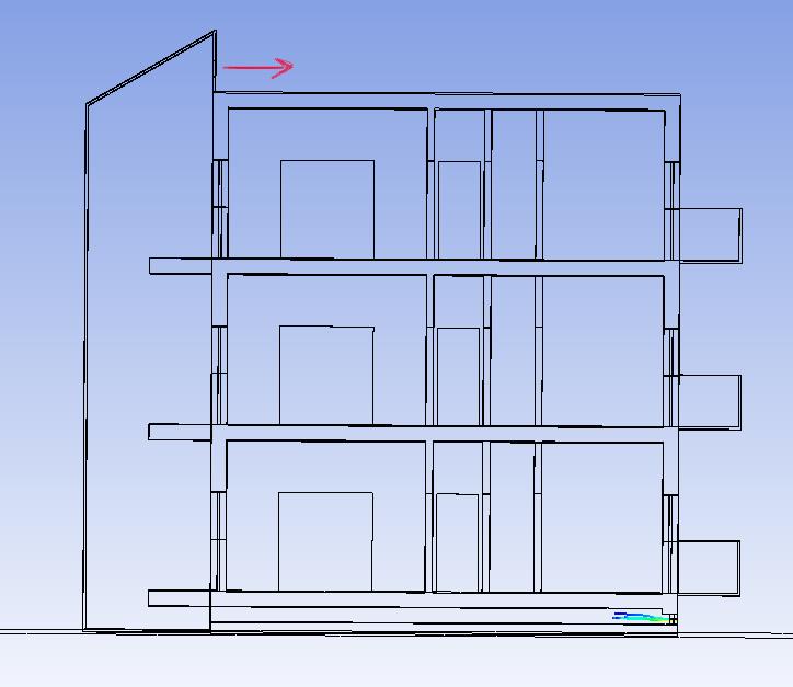

    • Kepojeyathas94
      I did as you say but the fan flow is very little.
      This is the velocity contour
      As you can see in this picture, the streamline is too little. I tried to put a fan where the streamlines begin and to get out from the building as the red indicator.
