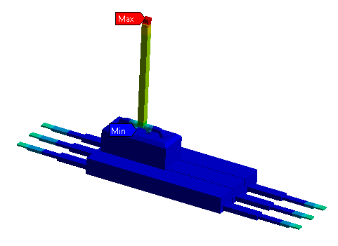

      I need to do Transient thermal electrical analysis, can it done in Ansys Workbench.

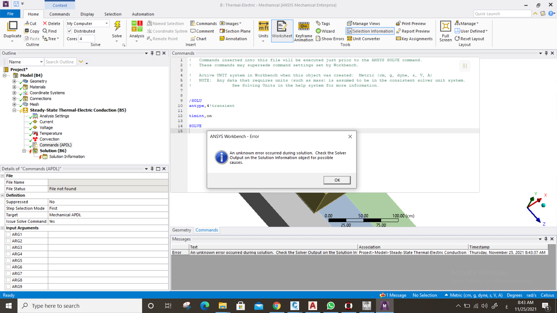

    • Pukmester
      Thank you for your reply
      but the model cant solve
      can you tell me where is the problem
      Thanks in Advance
    • dinhan0394
      He recommends 2 commands, but you use more and type it wrong
      Recommend:
      antype,4 ! transient
      timint,on
      You type:
      /SOLU
      Antype,TRANS
      Time, On
      SOLVE
      Repair them you will get result.
    • Pukmester
      Same problem
    • dinhan0394
      Change commands as he recommended.
      timint,on
      You will get result
    • Pukmester
      Could the reason be the capabilities of my pc
    • Pukmester
    • ErKo
      - you are not following ahat says - so use only this:
      timint,on
      So remove /SOLU not needed and you can not use SOLVE command again since Mech. will be solving anyhow.
      If you still get an error - go to Solution Information and in the Solver Output and find the error (ctrl+f and search for error). Post the error message in this discussion.
      All the best
      Erik
