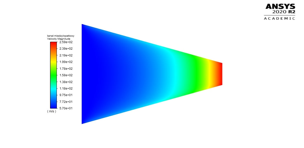

SubscriberHi friends, I have a problem. Im working in fluent and I have to make my flow inviscid but i also need to have velocity at wall = 0 so no slip. But when i make my flow inviscid i can't change my wall roughness? Is there any way you can help? There is photo of inviscid flow but with velocity at wall

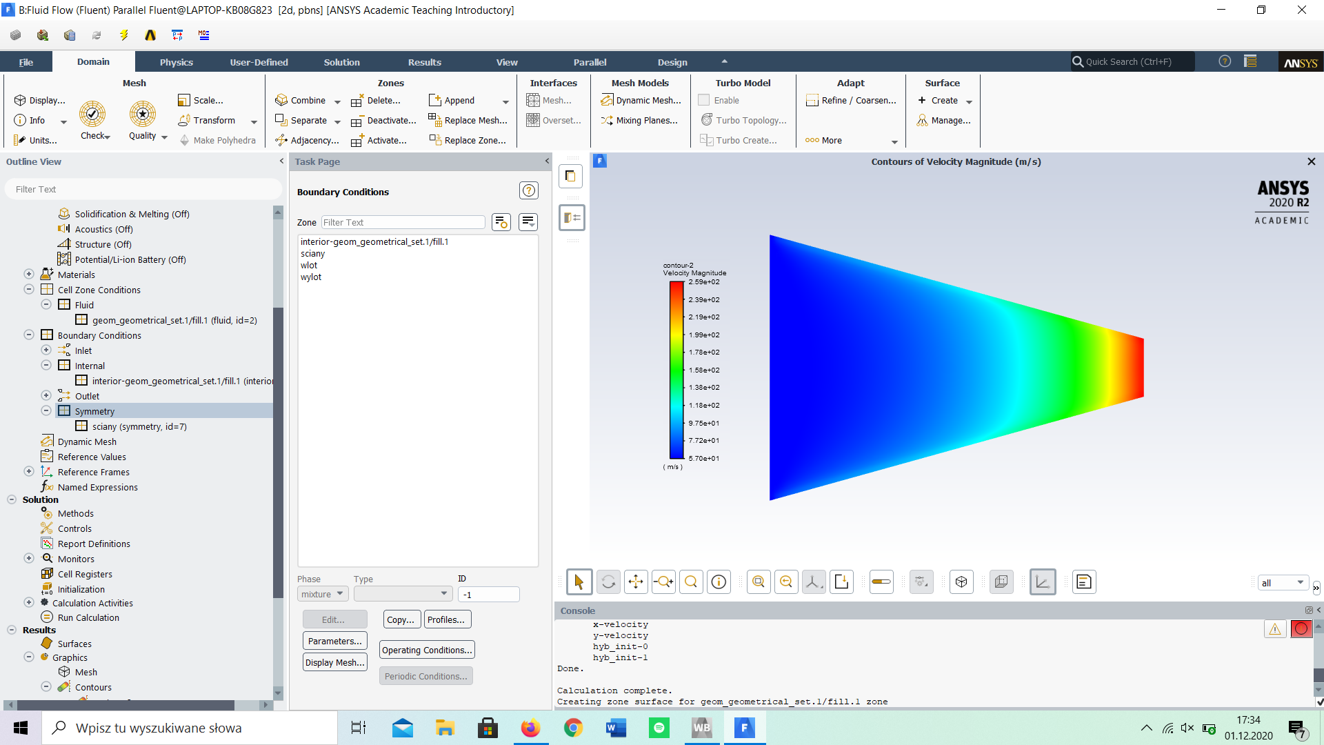

Forum ModeratorUse a symmetry boundary instead of the wall. nDecember 1, 2020 at 4:35 pmDecember 1, 2020 at 4:38 pmjuszczak10
SubscriberBut Thank you very much for your responcenDecember 1, 2020 at 4:49 pmRob
Forum ModeratorOops, misread, I thought you wanted a slip wall! Read the manual to understand what inviscid flow means, and how it's modelled. With that knowledge what else can you adjust? nDecember 1, 2020 at 4:59 pmjuszczak10
Subscriberis it even possible to make such flow? Like inviscid and velocity at wall 0 nDecember 1, 2020 at 5:02 pmRob
Forum ModeratorPossibly, but I'd need to read the manual. As it's home time here you can do that and tell me what you think could be done. nDecember 1, 2020 at 5:18 pmjuszczak10
SubscriberI cant think of any solution... im helpless in this case because im not advanced in fluent but thank you for your time i really appreciate it!nDecember 2, 2020 at 11:38 amRob
Forum ModeratorLook in User's Guide 9.5 Inviscid Flows. What's the main statement in that section. nDecember 2, 2020 at 4:41 pmjuszczak10
SubscriberIt does say that ,,Inviscid flow analysis neglect the effect of viscosity on the flow'' so i can assume that there is no possible way that the fluid will stick to the walls and velocity will be 0? Because inertial forces tend to dominate viscous forces nViewing 9 reply threads- The topic ‘How can i make my walls no slip but in inviscid flow?’ is closed to new replies.
