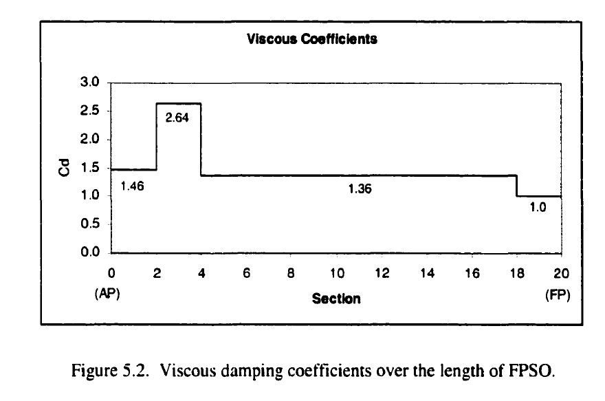

Ansys EmployeeHi, you could consider using several tubes along the length of the vessel to apply the different viscous drags. Just define the added mass coefficient of the tubes small enough to neglect.
May 10, 2021 at 1:31 pmAbuyusra
SubscriberMany thanks for your response, I will give it a try.
