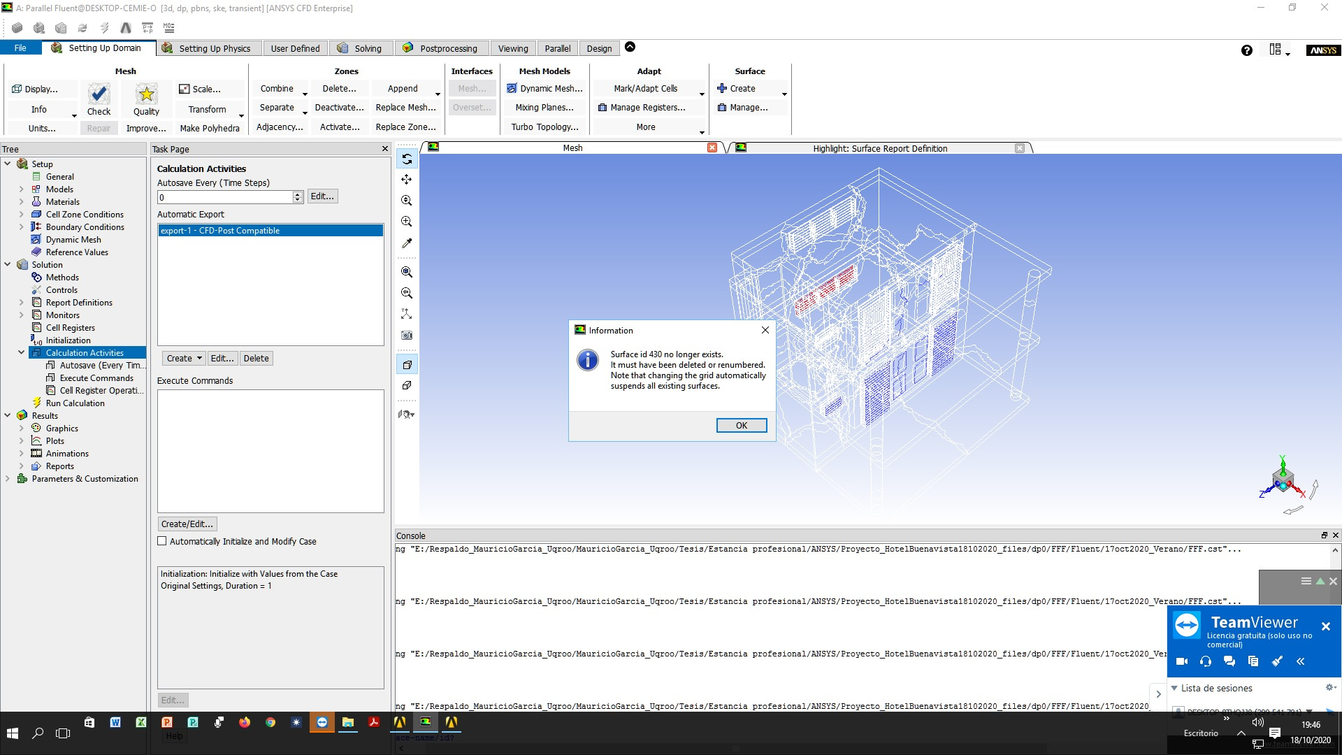

      I'm trying to create an automatic export in CFD-post compatible file type through the Calculation Activities Task Page, but when I designated the path of the file and click "OK" it shows me an Information Box saying that "surface id 430 no longer exists. It must have been deleted or renumbered. Note that changing the grid automatically suspends all existing surfaces". What can I do?
    • DrAmine
      If you are anyway exporting to CFD-Post: you just create any mising surfaces there. Just export the cell zone content with the variables you require and do the finishing in CFD-Postn
