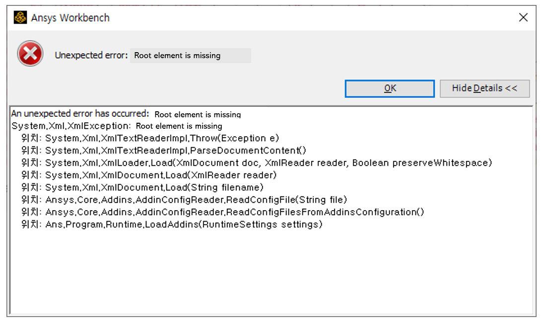

SubscriberWith 2021 R2, There's a "Root Element is Missing" issue while using workbench or Mechanical.
How can I handle?
you attach image for detail.

Please refer to the following discussion and let me know if this helps:

December 22, 2021 at 8:59 amejhan
SubscriberHi Vinayak As the link says, I changed the region but didn't work.
and first advice says that moving some files that cause issues and reinstall.
But I can not find System.Xml.XmlText - things in my computer
December 22, 2021 at 2:04 pmVinayak Vipradas
Try to clear the AppData folder and see if it helps. Following is the process-1. Exit ANSYS 2. from Start > Run 3. Enter %APPDATA% 4. A folder explorer window will open 5. Open the Ansys folder rename the v202 folder to v202_old (or whatever version you are using) 6. Launch ANSYS again and try to refresh the project

May 3, 2022 at 10:29 amtthytran
SubscriberI had the same erro, would love updated solutions to this
May 3, 2022 at 10:48 amErKo
Ansys EmployeeHello
What extension are you trying to use and what are the language settings on your machine?
(alo post the error message inline in your post so we can review it)
Also what are you trying to model since many of these extensions are now native in WB.
