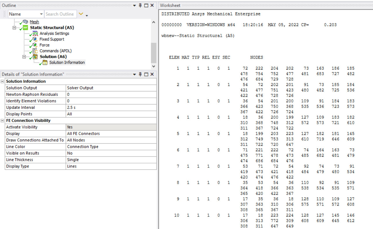

      Hi all,
      I would like to obtain information about element connectivity matrix, whic nodes are shared between two elements.
      The HBMAT commands give me stiffness, mass anda dampping matrix, but nothing about connectivity.
    • Ashish Khemka

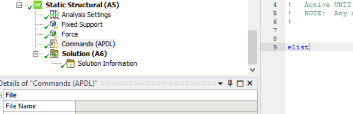

      Issue command ELIST and you will be able to see the elements and the associated nodes:
      Regards Ashish Khemka
