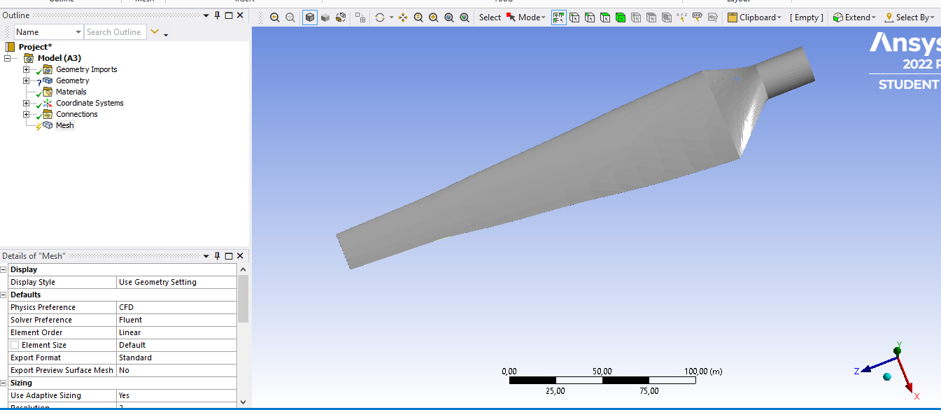

Gizem
SubscriberMarch 28, 2022 at 4:29 amKeyur Kanade
Ansys EmployeeThere is question mark on geometry. Please check geometry in SpaceClaim.
Select geometry in structure tree --> Use right click --> Select Check Geometry. (Or Tools - Fault Detection in DM)
The geometry should be error free to proceed.
If geometry has any errors, please modify/recreate geometry at those places.
Regards Keyur
