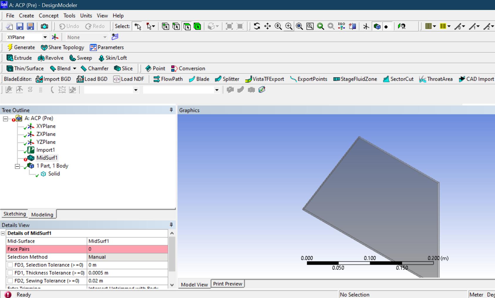

SubscriberAfter creating the mid surface can you try tomsee if youcan mesh it? That is where I am having problems.
I am using 19.2 R2 Student version

SubscriberYou have to get rid of the Rounds on the solid part before you can do a Midsurface. In SpaceClaim, go to the Prepare tab, click the Rounds tool, draw a box around the whole solid and click the check mark. Now you can click the Midsurface tool and get that done.
Attached is a 2019 R2 archive.

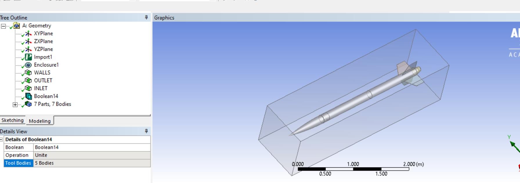

I did as you told me, to create the boolean using substract. (AS SEEN BELOW):
 I also used the boolean Unite(AS SEEN BELOW):

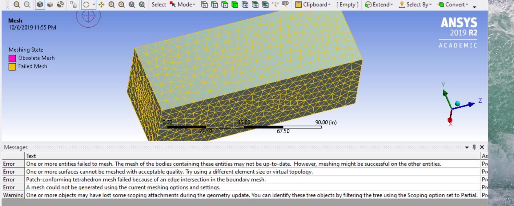

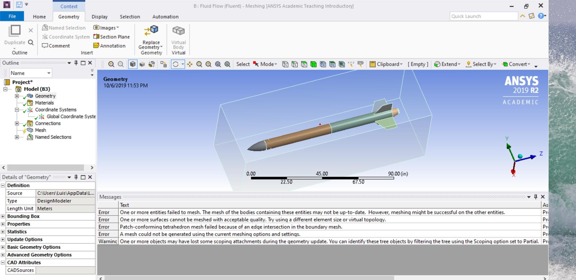

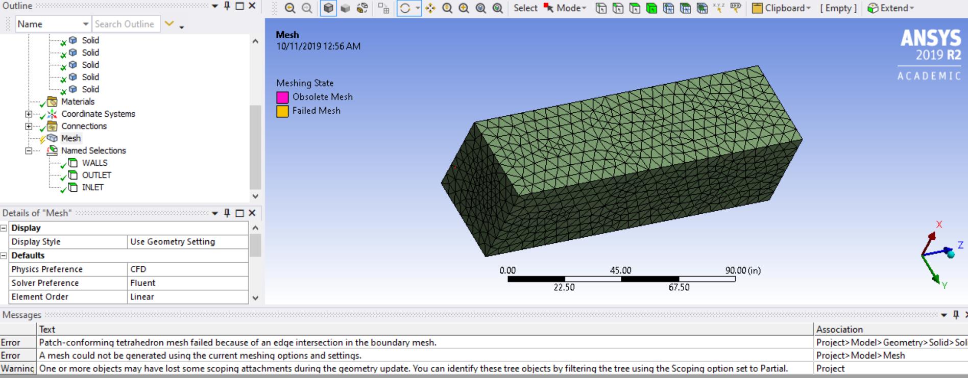

When meshing I still get error (AS SEEN BELOW):
I am using the regular quick mesh in Mechanic, is this the problem? Should I mesh it with another one? Or is there a problem with the stiching in the beggining with the boolean function?

SubscriberIf I open this Parasolid in SpaceClaim, there are many bodies.
The rocket body parts are hollow, they should be solid.
Fill all the body parts, then merge them all into a single solid body.
Then draw an air solid and subtract the single solid rocket body from the air.
