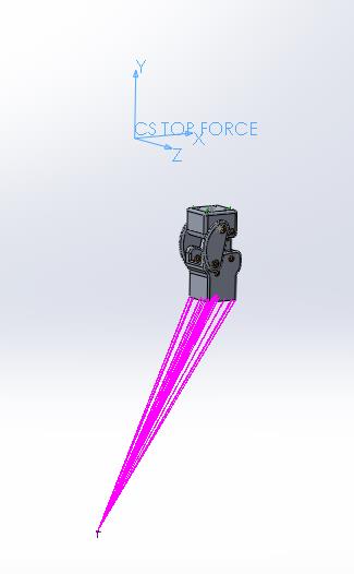

      I'm designing a mechanical knee prosthesis (optimal design), and i can't constraint the axial movement of the pins.
      Contacts between bushings and pins are no separation, bushing and links are bonded, links and solid faces of upper and lower pieces are frictionless (because i need to simulate the buckling load factor).
      A remote force of 2013N (ISO 10328) was applied in the bottom face and a fixed support in the upper face.
      Any suggestion?

    • LuisGil
      Hi peteroznewman!
      I´m using Ansys 18.1, there are the files of my WB project attached.
      I need to solve a eigenvalue buckling analysis, but I couldn´t solve the static structural analysis because i can´t constraint the axial movement of the pins and links properly. I tried many ways to do it but I don´t know how to.
      ISO 10328 describes two load conditions, where the compression forces are asymmetric.
      this is an example of the load condition 2.
      The bushing contacts are bonded because the are a press fit (ID of the links are 12mm and 10mm and OD of the bushing are 11.98mm and 9.98mm)
      The centerline of the pin is coaxial with the centerline of the bushing and links.
      The clearance between bushings and links are 0.1mm.

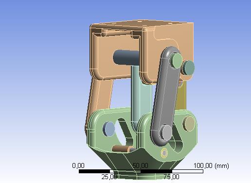

      I suppressed all the pins, shafts and bushings and was left with a 4-bar mechanism. I created a revolute joint at each pin location.
      This model has no static solution because it is a mechanism. If one of the joints is changed from a revolute to a fixed joint, then there is a static equilibrium solution.

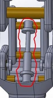

      Arbitrarily changing a revolute to fixed is not correct. There must be a locking mechanism that keeps the knee joint locked in the straight position. In the image below I see a center link connecting two shafts and a telescoping pair of parts. I expect there is a heavy spring (not shown) between the telescoping parts.
       I can add these parts in and a spring, then there will be an equilibrium position with the remote force. I took some shortcuts by using joints that had one side along the whole length of a shaft. If I was doing this more carefully, I would replace the joint with contact, or split the face so that only the portion of the shaft touching the other part is part of the joint definition. But at least this quick model shows the elements needed for a static solution. Note that I turned on Large Deflection in the Analysis Settings.
      The center spring is supporting a 10,275 N tension force.

      What you pointed out in this image is the Knee-Extension-Assist System. In the straight position, the KEA System will not exert any force, because the spring is in free position, that´s why I supressed that system in the analysis

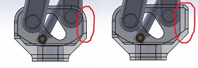

      There is no locking mechanism. The Prosthesis has a blocking stop as you can see in the image below. It was modified to improve the contact surface.

      A good strategy when model building is to get the simplest possible model running first. You will learn 80% of what you need to know from the simple model. Then you can build a refined model to fill out the remaining 20% of the information. Of course you will spend 80% of your time building the refined model after only having spent 20% of your time on the simple model. By suppressing everything but six parts and creating eight joints plus one contact, you can solve the statics problem. That took me < 10 minutes before I could hit solve.
      Now I see the stop, I should have noticed that before. I added frictional contact between the links and stop and used Adjust to Touch to close the small gap. I dragged and dropped the contact onto the mesh to create mesh refinement at the contact point, then I added a Face Sizing mesh control on the stop face. I turned Large Deflection on and turned on Auto Time stepping. Now the Static Structural model solves.
      Unfortunately, the Maximum Equiv. Stress is much greater than the Ultimate Tensile Strength of Aluminum Alloy, which is 310 MPa. It is clear that this load will cause the stop to fail. Does the solution to the Eigenvalue Buckling problem even matter after learning this?
