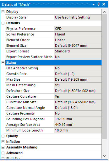

      When I am clicking on the orientation visualization icons, such as show fiber direction, show orientation, etc., those are not working. How can I activate those icons (shown in picture)?
      Thanks in advance.
      Mohin

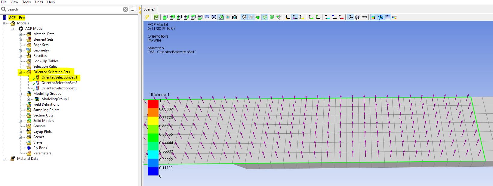

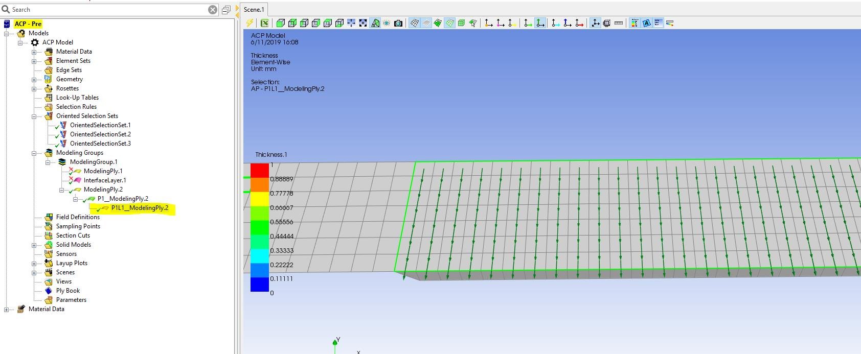

      To highlight the orientation direction or fiber direction, you need to click on the orientation or ply at the left tree (Shown below).
      Bests,
      Wenlong
