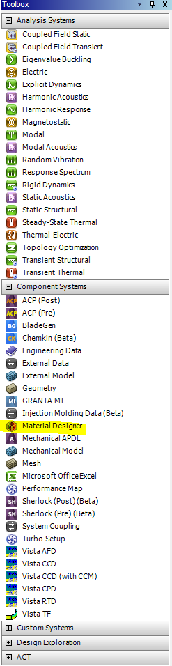

      Hello Oguzhan, so you will want to get on that licensed version, then fire up Material designer. See image below as to where it can be found in the Workbench toolbox. It has a wizard that is pretty straight forward. You need to specify the material properties of the fiber and epoxy, and then go through the wizard picking what type of material (UD, woven, etc.) It will finally solve for the orthropic material constants. You can search around on the internet for similar materials maybe to get and idea on the Poisson's ratio or the fiber or epoxy or even contact the manufacture.nHope this helps get you started with that tool to get 9 orthotropic material constants you need.nnThank younSeannn

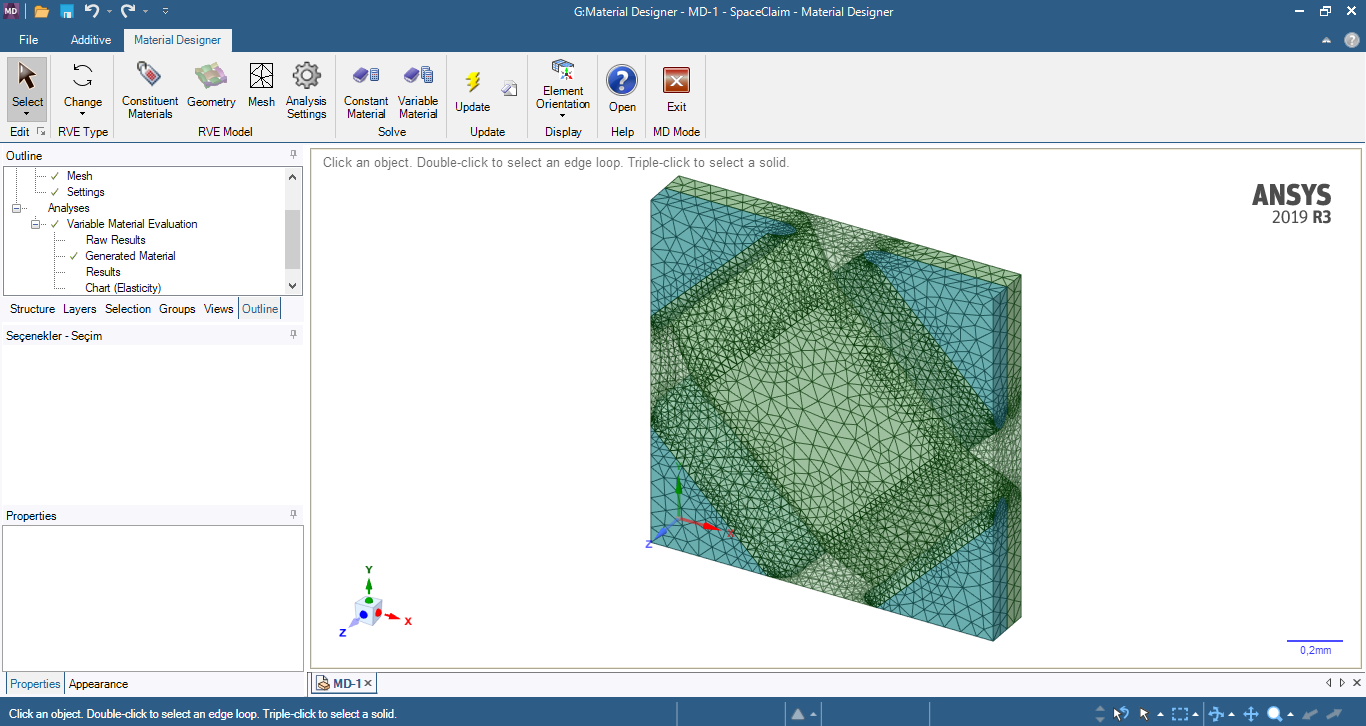

      I tried to use this section and obtained this material. This is woven carbon epoxy material.nBut now,I don't know how can I create cylinder. (1 mm steel-and cover carbon epoxy)? Because I have 7 models. Not every model is completely covered. Some of them have only certain areas covered with carbon epoxy.nn
    • Sean Harvey
      Hello OguzhanAnSo you would use this as engineering constants for a material in engineering data. In fact you can connect the Material Designer to Engineering data to pass this. nYou will add the steel material (actually it will be in there by default) Then you need to setup your geometry, mesh. You can split the surfaces of the cylinder in Geometry (SpaceClaim) and then use name selection in Mechanical to indicate regions, then in ACP, you will use the oriented element sets to reference these regions (Element Sets) that have the different layups. You have to specify the layups of the carbon in ACP in the modeling ply. Much of these steps are covered in YouTube videos on ACP. See if you can find one and follow along on the basic usage of ACP.nnDoes that help?nThanksnSea

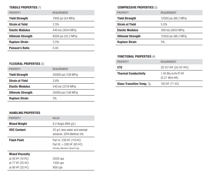

      I found details. nSTEP-1 : I will apply SAT4500 (Epoxy encapsulation resin) about 1 mm.n Figure-1: SAT4500 PropertiesnnnSTEP-2: Then I will apply my fibre fabric. n Figure-2: Fibre Fabric PropertiesnSTEP-3: Again apply SAT4500 .nquestion-1 : I watched ANSYS material designer tutorial and firstly I created Epoxy Carbon UD then created epoxy carbon woven. When I created epoxy woven, I used resin. Now in ACP, will I use resin again ? or Should I use resin (for sat4500-1 mm) ?nquestion-2: If I define fabric in ACP, Should I define three fabric ( 1 mm SAT4500 Resin-Epoxy Carbon Woven-1 mm SAT4500 Resin)nRegards nOguzhanAn
