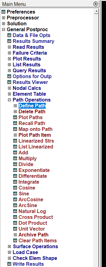

How can calculate a stress along centre line of single lap adhesive bonded joint of rectangular 3D s
March 15, 2021 at 7:02 am
pateldineshkuma
SubscriberI am working on ansys 17.2 apdl n -
March 19, 2021 at 6:20 pm
Sean Harvey
Ansys Employee,nTo do this interactively you can use the Path Operations in General Postproc. See image below. You will use the define path to set the path by nodes or location, then the Map onto path to set the quantity to the path, and finally use Plot path items to make contour or graph. The commands for these 3 main operations arenpathnpdefnplpathnLet us know if this helps. Thank younSeann
