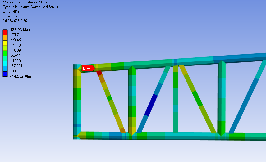

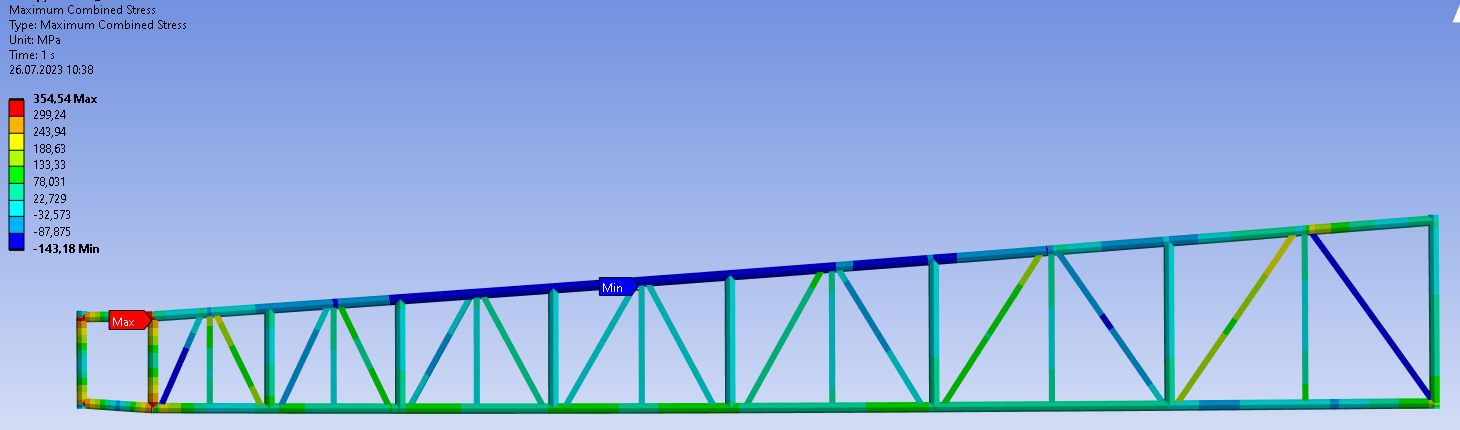

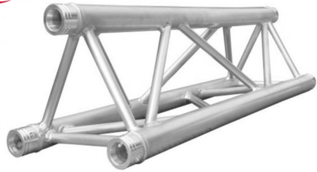

SubscriberHi all. Recently I did a calculation with beams and I had a few questions about their work in ansys and the interpretation of the result. In the results, I analyzed Max Combined Stress, which is the combination of forward stress and maximum bending stress. I think this is what you need when analyzing a steel truss.
If it shows me the maximum voltage on one of the corners, can I pay attention to this and say that this is the weakest point (where the maximum voltage is)?

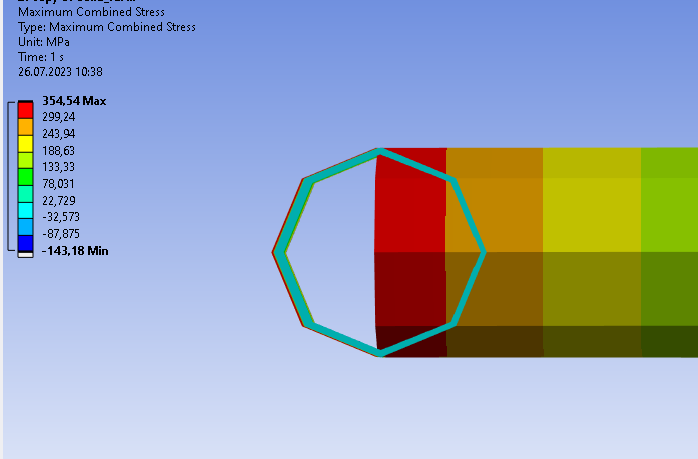

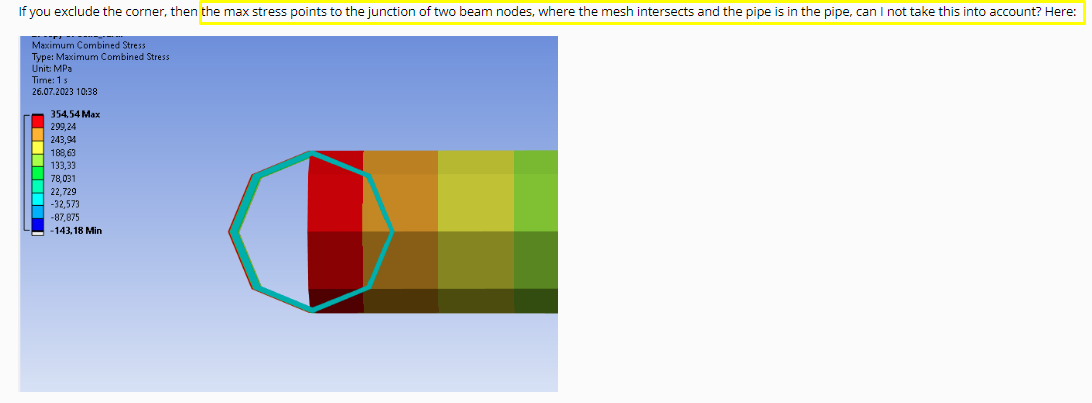

If you exclude the corner, then the max stress points to the junction of two beam nodes, where the mesh intersects and the pipe is in the pipe, can I not take this into account? Here:
Do I need to take into account the negative voltage? After all, in theory, this voltage is simply directed against the axis.

Ansys EmployeeIn the US there is the AISC code that tells you how to evaluate beam stresses. Are you working to such a code? If you don't have a code and just want to stay below the yield stress of the material then the Maximum Combined Stress can be used for that. Negative stresses would be significant if you were concerned about buckling.

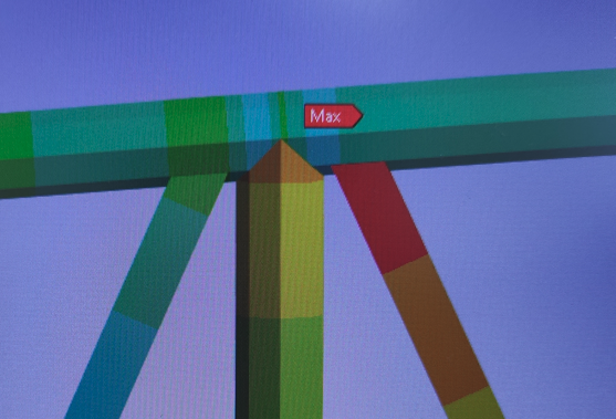

SubscriberBeam models are a very idealized model that ignores a lot of detail so that basic sizing calculations can be performed and the design iterations can be rapidly done. Once the design has converged on a potentially feasible solution, a detailed model is often built to look at the stress around the actual welded connections between the truss ends. The photo below shows welded ends. A detailed model could be built to analyse the stress, which will probably have higher stresses than the simple beam model due to stress concentrations.

SubscriberI understood you. Thank you. I will try. But anyway. When analyzing beam elements, if the stress is on a beam that is inside another beam (at the end), can I turn a blind eye to this?
August 9, 2023 at 10:10 am
peteroznewman
SubscriberNo.
August 9, 2023 at 4:55 pm
javat33489
SubscriberOkay, so you need to ensure that there are no such tensions.
