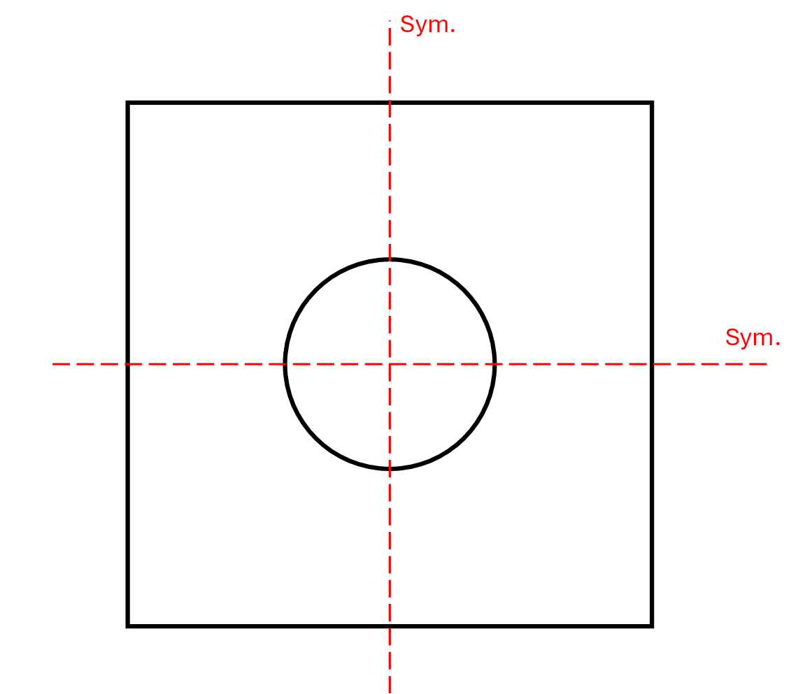

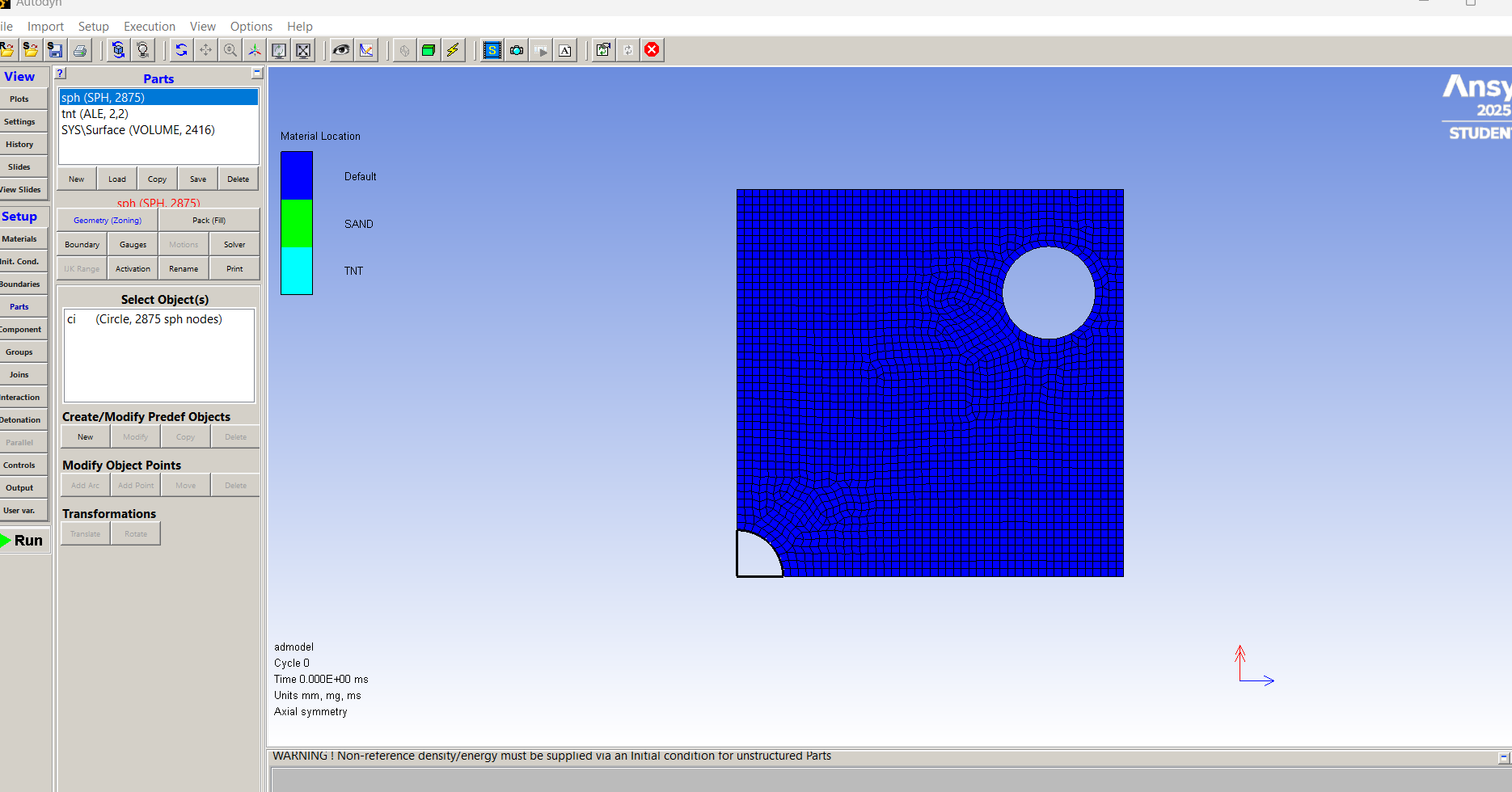

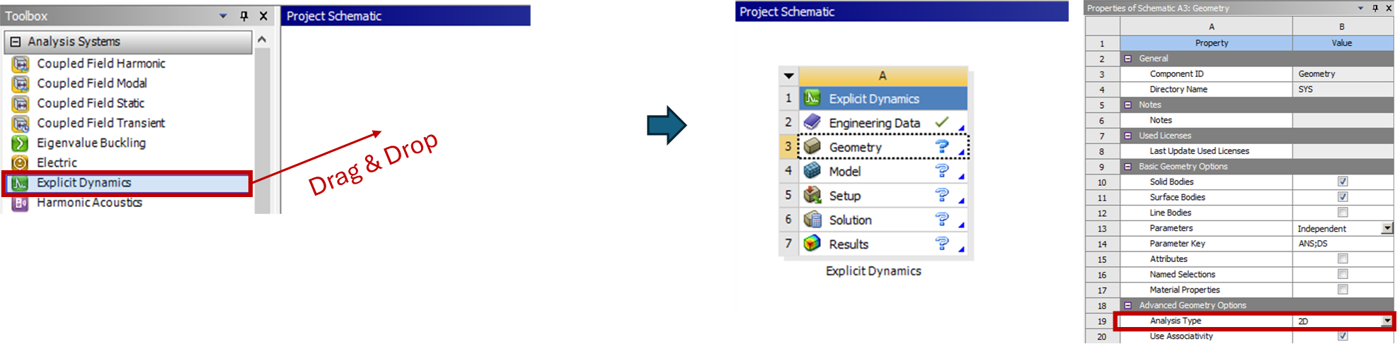

      Hi, I want to model a circular hole in a rectangular model using AUTODYN with axial symmetry. However, I don’t see any tools for this operation. Could you please advise?
    • Armin
      Could you elaborate on the model? For instance, does your model include an existing hole, and is your goal to leverage symmetry by modeling only a portion, such as 1/4 of the geometry (Please refer to the picture below.)

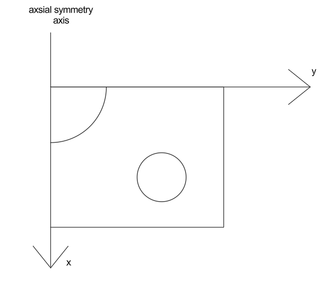

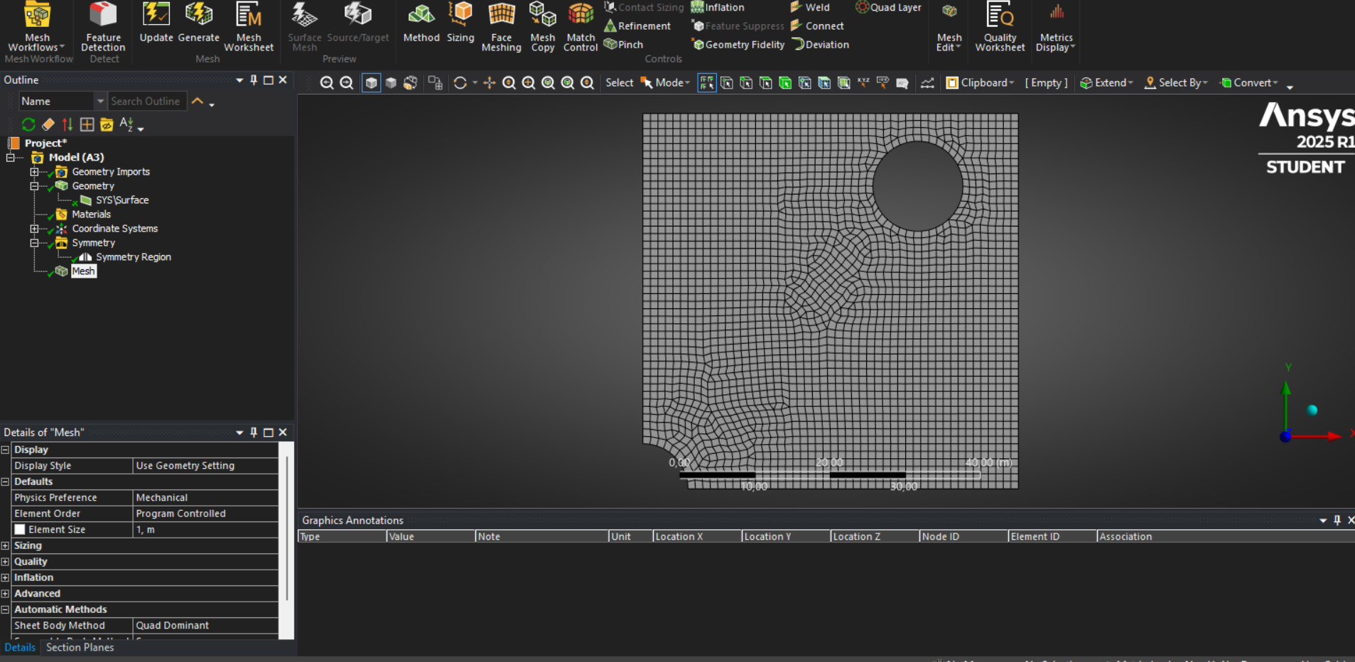

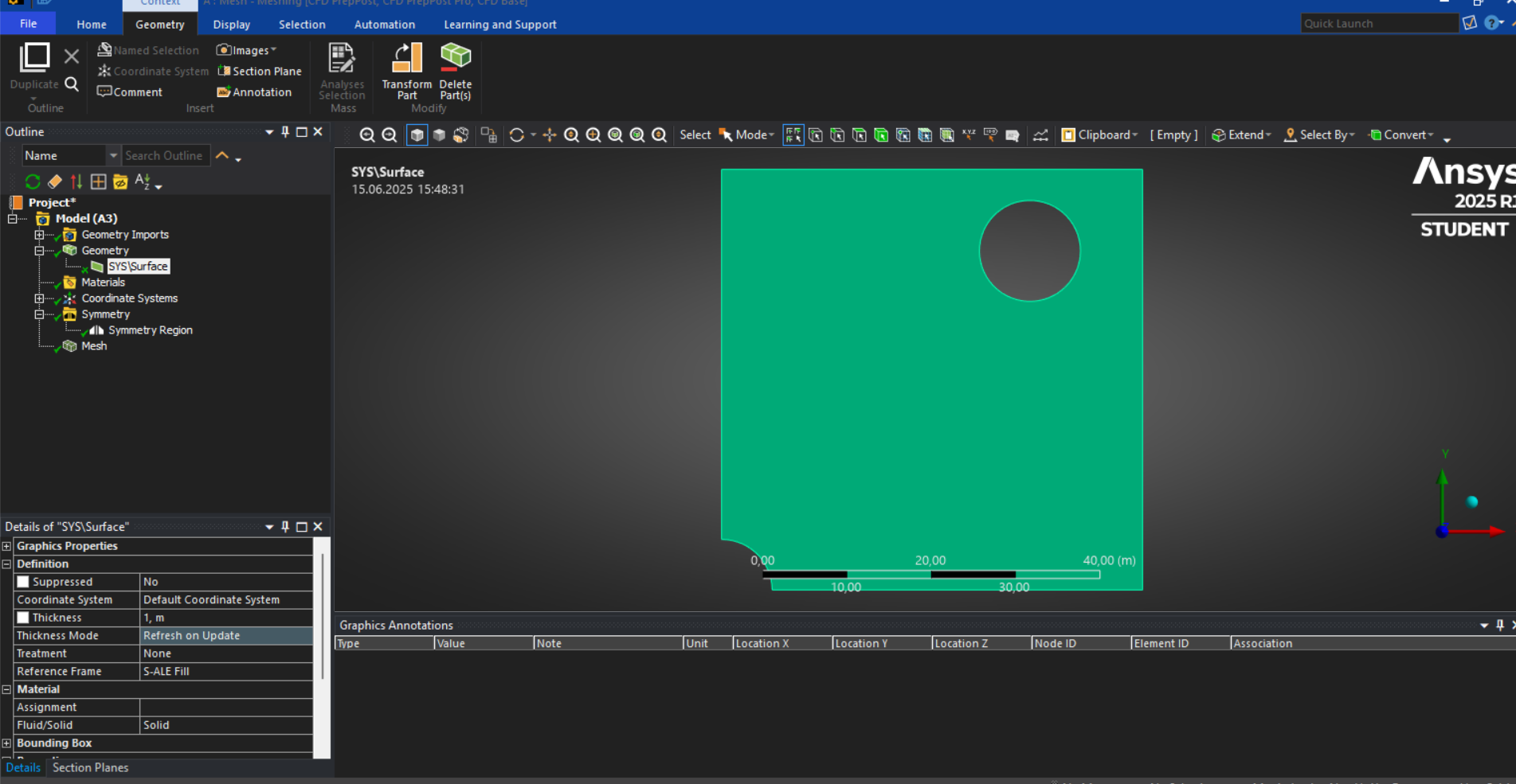

      Hi, I want to do circle holes in ma rectangular 2D geometry, bellow I attach a schem. In upper part i am going to do 1/4 cirle hole and use axial symetry.
    • Armin

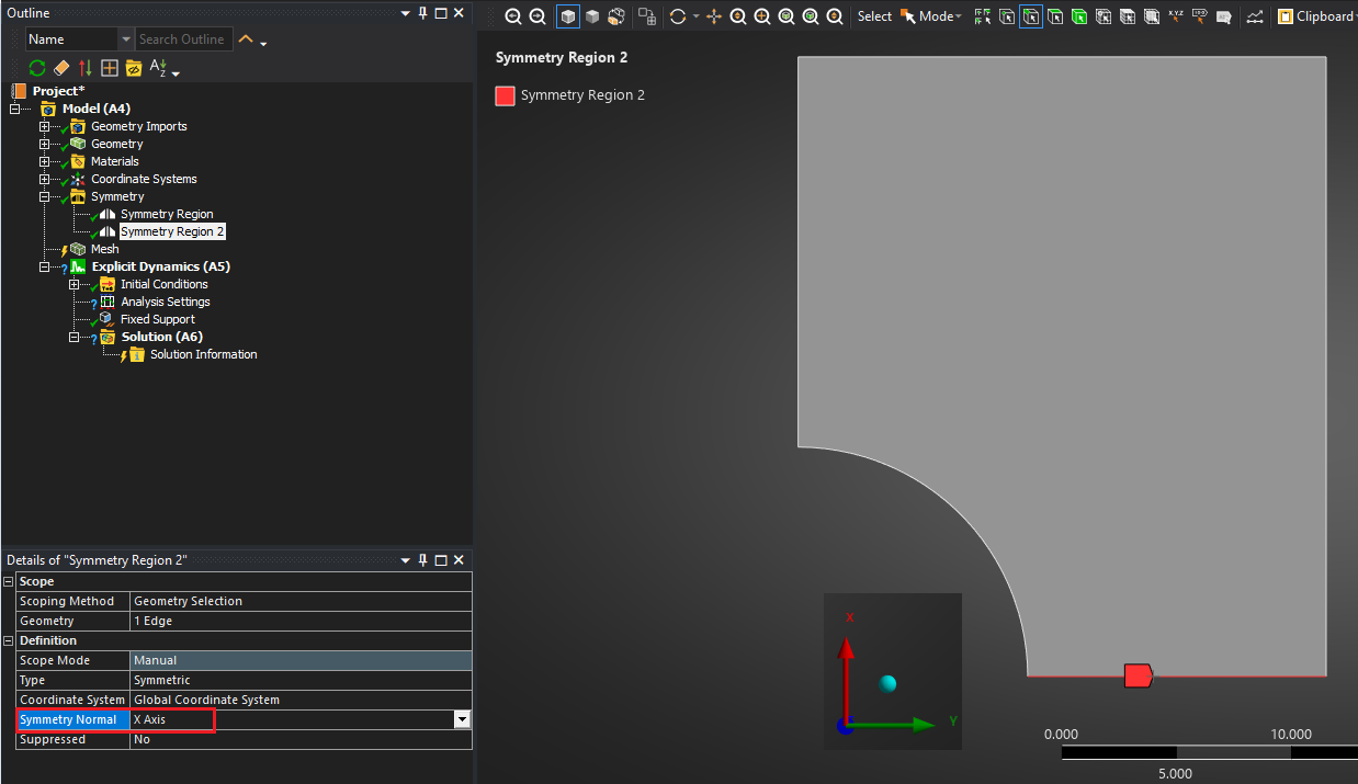

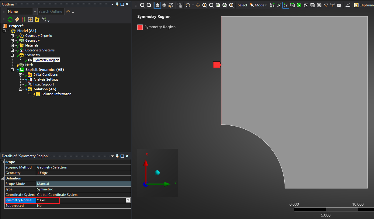

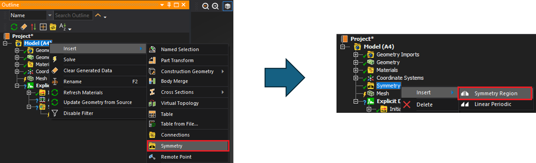

      Please refer to the screenshot below for instructions on how to insert a 'Symmetry Region' and assign it to the appropriate edges of the model. Note that the 'Symmetry Normal' must be selected carefully to ensure proper consideration of symmetry.
