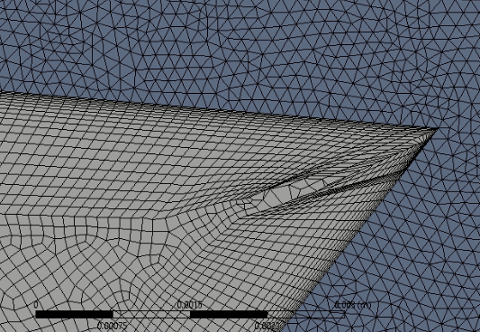

SubscriberHi, I am using ANSYS Meshing and am being faced with a high skewness at a very few elements due to the geometry of the corner. I do not have the time to learn ICEM so is there a means of minimising, or better so, eradicating the high skewness shown below? Many thanks in advance for your help.

Ansys EmployeeHi What kind of mesh operations are you using? Try element sizing with "behavior" as "soft" . If the issue persists, I would recommend you to try polyhedral mesh, which will impart good quality mesh.

SubscriberThanks for your comment however I had circumnavigated the issue by rounding the corners.
