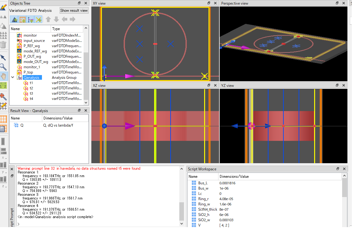

I am trying to simulate high Q ring resonator using varFDTD. In experiment, we have a Q factor of about 10e6 with critical coupling distance of 400nm. So this is a high Q resonator.
June 25, 2021 at 12:41 amKyle
Q factor calculations can be very difficult, especially for high Q structures. It looks like you need to increase the simulation time even more to get reliable results.

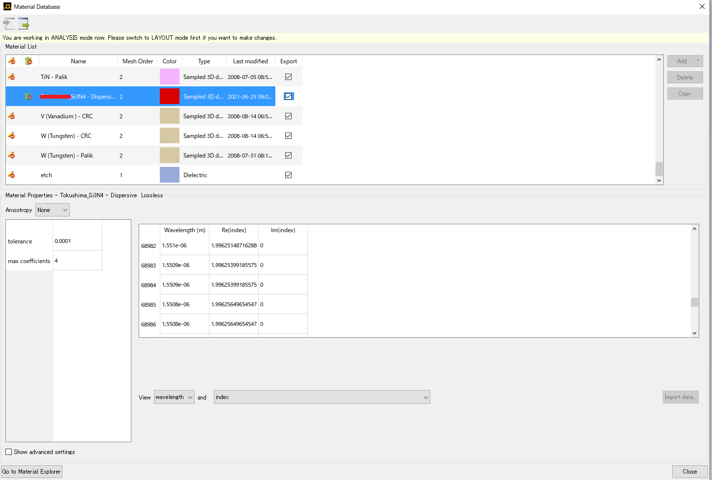

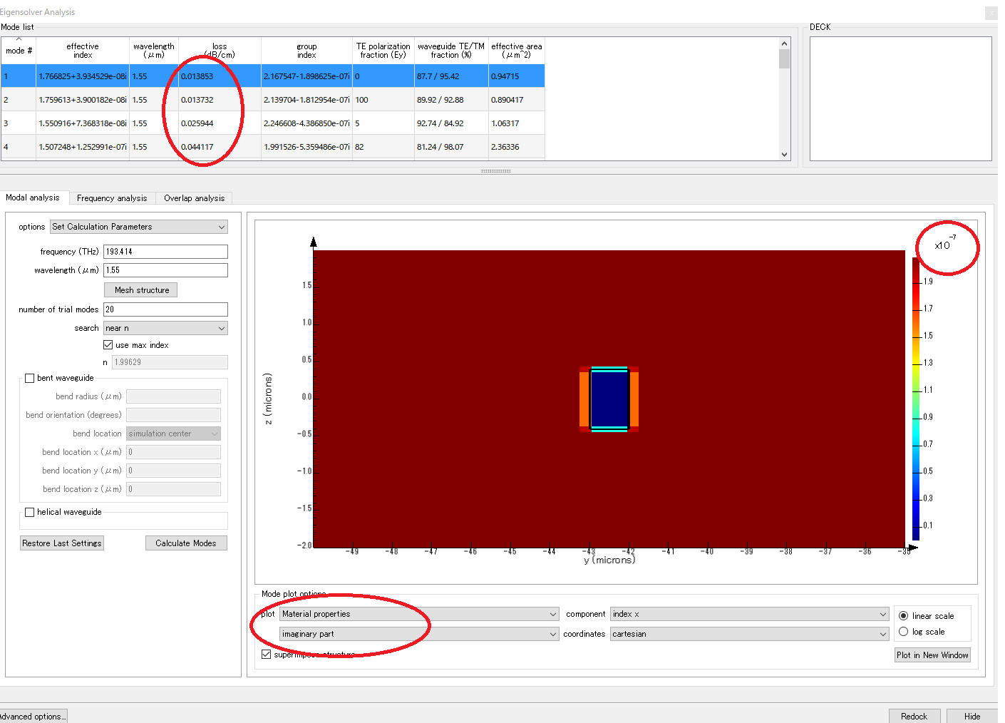

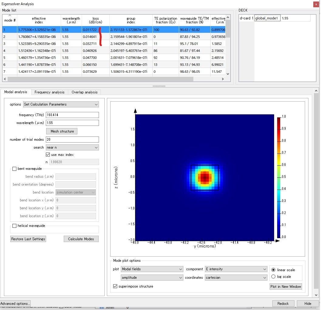

SubscriberI cannot use interconnect in my case as I am using sampled material data . I insert the index of the material myself. Is there a way to do the same in interconnect. I think the ring in interconnect is for Si ring only. Right?

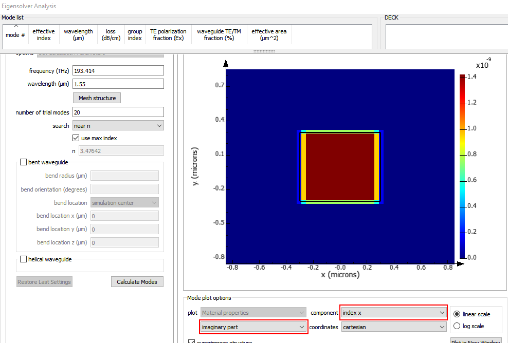

Another question please. I am using a lossless material data with imaginary index value of zero. However, when calculating the modes, I have a loss value in the "Eigensolver Analysis" mode list starting from 0.011722dB /cm for straight waveguide and increase as I do bend analysis.
How this loss value can be interpreted with index imaginary part of material equals to zero.

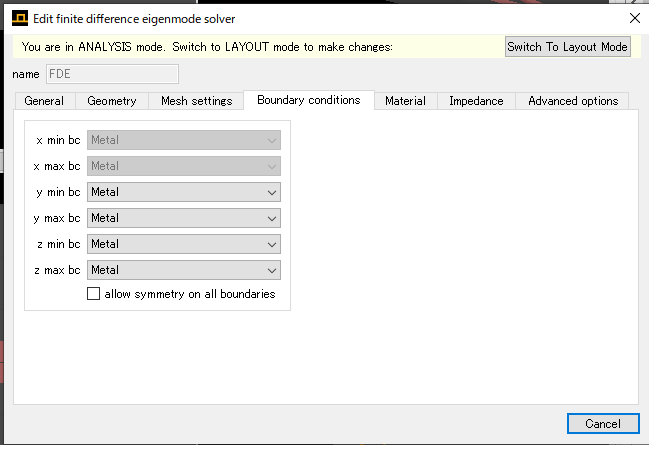

Can you please give some more details on your FDE simulation? Is it a leaky mode? Do you include a high-index substrate in the FDE simulation region? What boundary conditions are you using? If you have a high index substrate, or you're simulating a leaky mode, there could be losses due to radiation. However if you have a bound mode, these could be artificial losses from the PML boundary conditions being too close to the waveguide core. In this case you should use metal BCs and increase the span of the simulation region.
June 28, 2021 at 3:01 amJune 29, 2021 at 12:19 amKyle

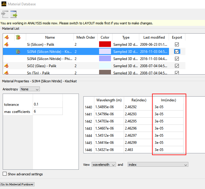

Ansys EmployeeThank you for the screenshots. If you are using metal BCs then the losses must be through material absorption. If you look at the material data for the Kischkat Si3N4 in the Material Database you can see that the imaginary part of the index is non-zero:
This is where the losses are coming from in your simulation. If you would like to simulate a lossless material, you can specify the index directly by selecting "June 29, 2021 at 12:58 amomnia.nawwar

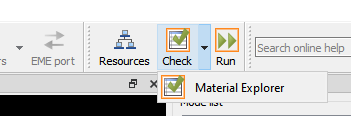

Ansys EmployeeWhen you visualize the material data in your simulation is it zero? For example, after meshing the structure:
What does the material fit look like? You can plot the material fit in the Material Exploter:

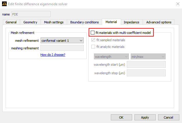

Do you have the "fit materials with multi-coefficient model" option of the FDE solver object turned on?
July 2, 2021 at 1:44 amJuly 2, 2021 at 5:16 pmKyle
Thank you for the screenshots. It looks like the cladding/substrate has a non-zero imaginary refractive index, which is what's leading to this loss. If you're using a fitted material there might be a small imaginary refractive index in the fit even if it's not present in the data. You can check the material fit in the Material Explorer. Instead of a fitted material, you can use index values interpolated between the material data points by turning off the "fit materials with multi-coefficient model" option of the FDE solver object(see my previous post).

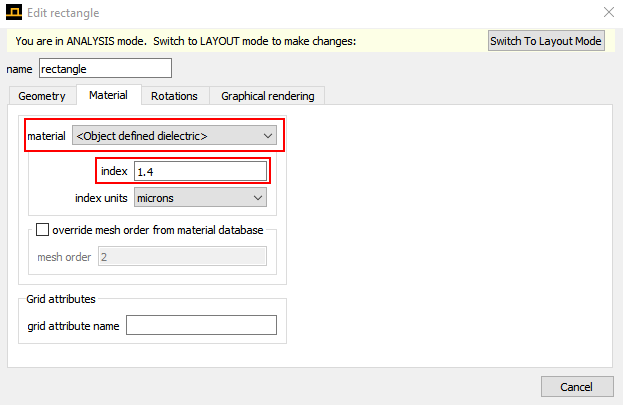

You could also remove this loss by replacing the cladding/substrate material with a material with constant refractive index (for example anJuly 9, 2021 at 4:22 amomnia.nawwar
SubscriberThank you so much for your help. looks like it is the source of this loss
