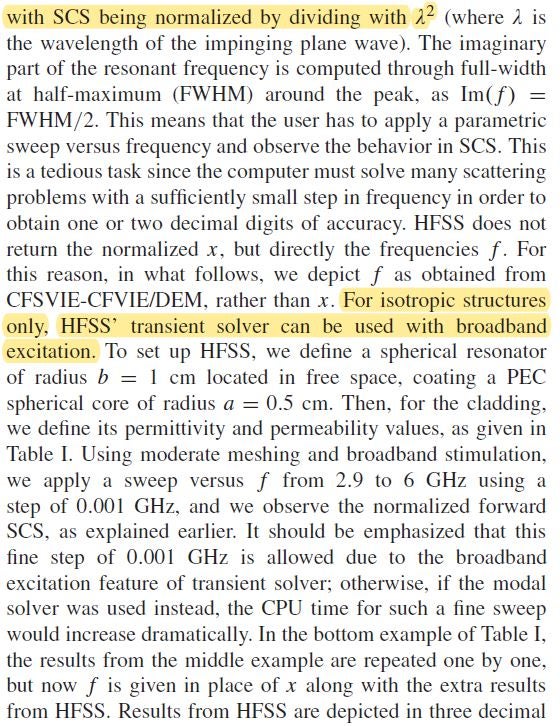

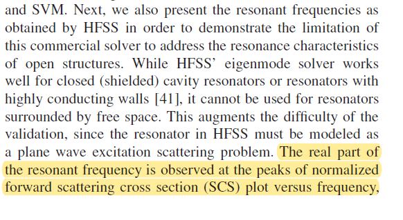

Ronny Roy
I have used eigenmode solver. I want to find resonant frequency using a transient solver as given in the attached paper. Kindly suggest the steps for the same. I want to replicate the results of attached paper.https://ieeexplore.ieee.org/document/8410939/
June 27, 2023 at 12:13 pm
GioF
Ansys EmployeeRonny I won’t be able to check the publication, so I will provide some information based on the provided screenshots.
Based on the attached screenshots, you can do the following. First select the Transient Solver Solution Type. To do so, click on HFSS and select Solution Type.
Create 2 spheres one inside the other and place them inside a bigger box. The outter box region will be used as the vaccum and a radiation boundary should be defined in its outer faces. Select the box right click and do Assign Boundary>Radiation. Assign the inner sphere as PEC and the outer sphere with an isotropic dielectric material. After that you should assign a plane wave excitation by right clicking on Excitations>Incident Wave>Plane wave. Define the wave coordinates and direction and in the Transient Tab of the Incident Wave, select Active.
The issue with the attached screenshots is that a frequency sweep of 2.9-6 GHz with a time step of 0.001 GHz is mentioned. Since, transient solver is a time domain solver a frequency sweep is not defined. In the input signal Tab you can define the Min and Max Frequencies as well as the number of extracted frequencies. You can try adding a solution setup by right clicking on Analysis>Add Solution Setup.Set the Solution Setup options as needed. In the Radiated Fields Tab enable the Save frequency domain radiated fields if you want to plot the CrossSection results.
Last, right click on the Radiation and click on Insert Far Field Setup>Infinite Sphere. Simulate the model and plot the results.Â
