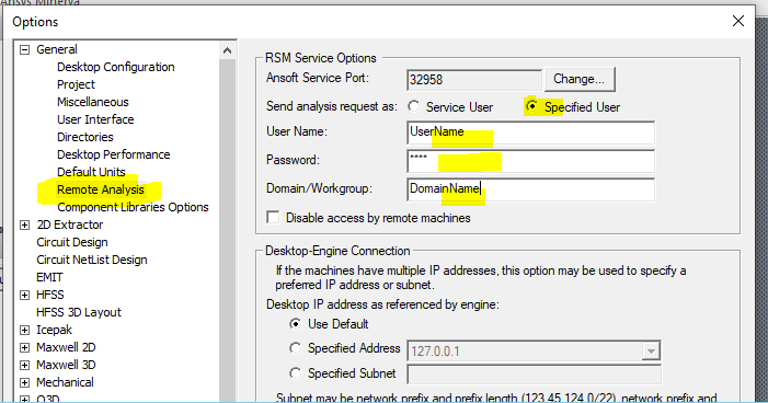

      AEDT setup
      Tools -> Options -> General Options -> Remote Analysis ->
      [x] specified user
      enter username, password, domain

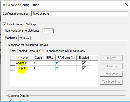

      AEDT setup (continued)
      Your Analysis configuration should have the localhost listed first and then the remote computer:
      Please let me know if this resolves the issue
