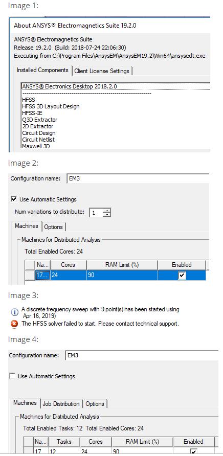

      We are noticing an issue where we are unable to simulate remotely if we use the automatic settings. I am using Ansys Electromagnetics Suite 19.2.0:   image.png   I specified 24 cores in my analysis configuration in HPC and Analysis Options:   image.png
        The adaptive solution process works fine, but frequency sweeps throw an error saying that the HFSS solver failed to start:   image.png
      If, however, I uncheck the 'Use Automatic Settings' box in the analysis configuration, frequency sweeps run with no errors. For example, the following configuration works fine:
      Can you help us understand this error? Are we are losing performance by not using automatic settings in the analysis configuration, and does it really make a difference if we specify Total Enabled Tasks and Total Enabled Cores

      Here are the reposted images.
      Image 1:
      Image 2:
      Image 3:
      Image 4:

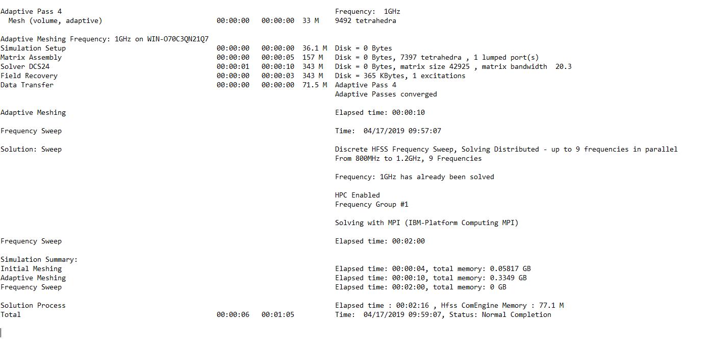

      Here is the profile:

      Here are the photos again, I can see them on this post with multiple computers so I am not sure what is happening:

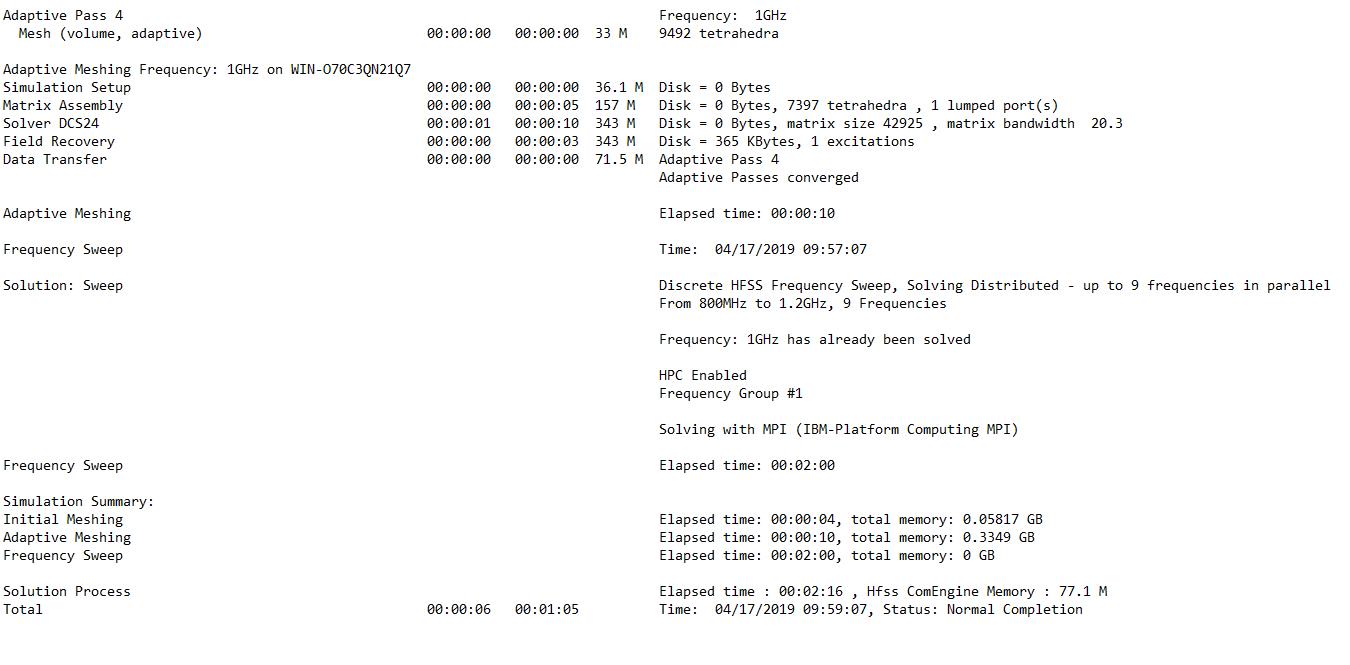

      We are having the same issues with 2019 R1. Here is the profile:
      This profile was done with the automatic settings enabled.

      It seems like the auto setting is trying to solve on 9 tasks.
      Also, when you uncheck the auto setting, you are actually using 12 tasks ? I might have misunderstood your statement here
      "we can only use one task on a single core"
      so this 12 tasks + 24 cores setting work fine ?
      I'm not sure why auto setting is trying to solve on 9 tasks while you are specifying 24 cores. It's not balanced.
