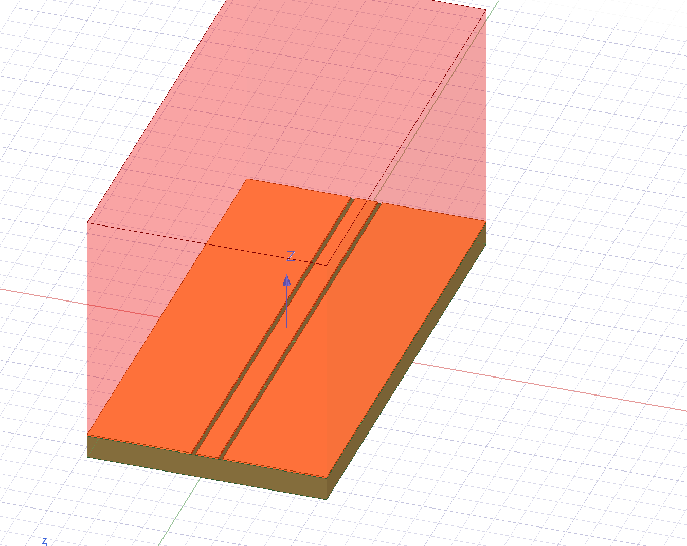

SubscriberHello everyone, I'm using wave ports to simulate the S-parameters of a CPW with ground. However, I've encountered an issue where the plot field function is disabled after simulation. Is there a method to visualize the electric field of my device?
Additionally, I'm curious about the S-parameters shown in dB. Are these values calculated based on power or voltage? Thank you for your assistance!
August 28, 2023 at 3:03 pm
Aymen Mzoughi
Ansys EmployeeÂ
Make sure you are plotting the field for the solution frequency, or use a discrete sweep and save the fields for the frequency points you would like to investigate.
