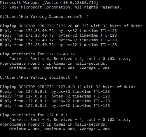

      Also, from CMD Prompt, issue the following commands and post the screenshot of the output here
      ping %computername% -4
      ping localhost -4
      Thanks,
      Win
    • Han-yu
      Hi:
      I installed McAfee antivirus, I turned it off but the HFSS still not working.
      And the commands shown in the following image.
    • tsiriaks
      When you turn it off, by default Windows runs Windows Defender (Firewall and Virus protection) , please check this.
      The output of your CMD Prompt looks good. Also try the command
