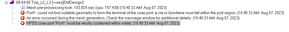

Ansys EmployeeHi Muhammad,
Please check if the reference terminals fall entirely within the reference plane/ground plane. Please refer to the help document of HFSS 3D Layout for more details about port creation.Â
