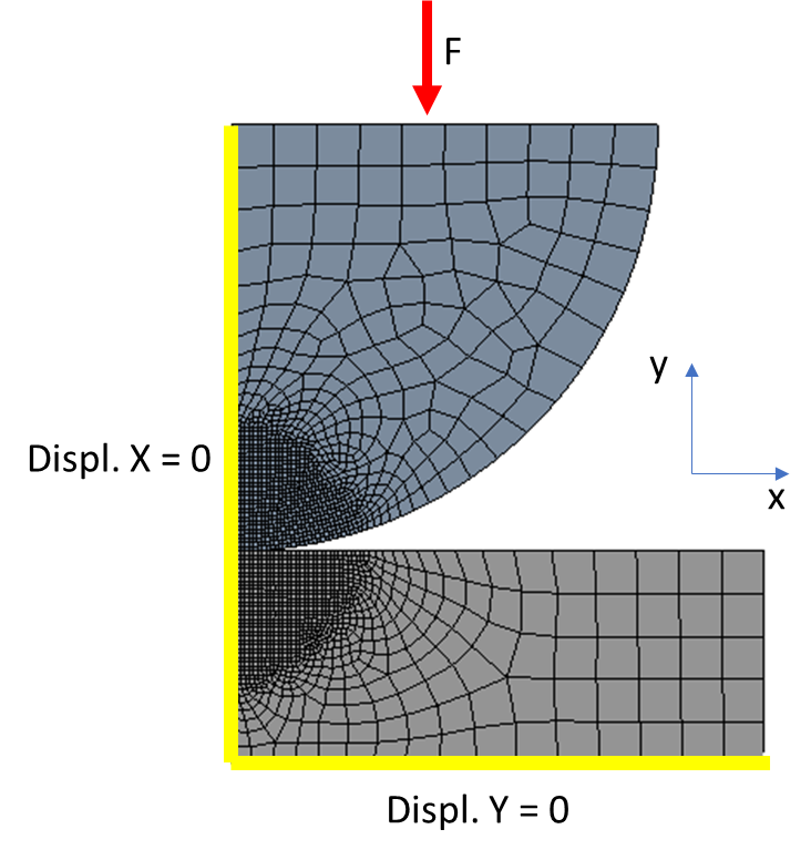

I would like to ask for help for configuring this simulation. I've seen some posts here in the forum, but for some reason I am not being able to properly reproduce it myself.
The problem is a standard Hertzian Contact between a sphere and a plane in which I want to evaluate identation, stresses and contact radius to compare to the analytical solution. I am simplifying it to a 2D problem with symmetry. Picture below shows geometry and boundary conditions:
Frictionless contact between bodies. Geometry analysis type set to 2D plane strain.
When I try to solve it, I get an error that "An internal solution magnitude limit was exceeded", pointing out to nodes in the circle regarding the UY direction. Now, I know that that are indeed no constraints to prevent that movement, but I need the circle to be able to move in UY so I get the stresses and deformations, isn't that correct?
Could anyone please help me to understand how should I properly constrain this model to perform the analysis I want?

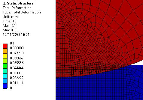

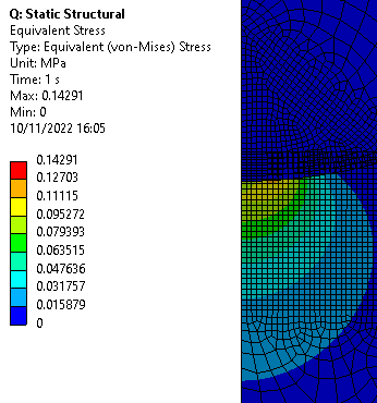

November 10, 2022 at 3:21 pm
henrique.geraissate
SubscriberHi Sean,

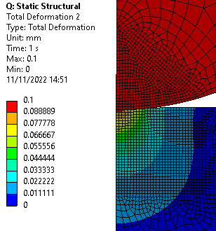

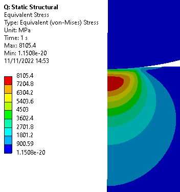

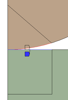

I just tried that out with a vertical displacement of -0.1 mm and, although the simulation converges, I think it is indeed not properly detecting the contact. Please check the deformation and equivalent stress results in the pictures below:

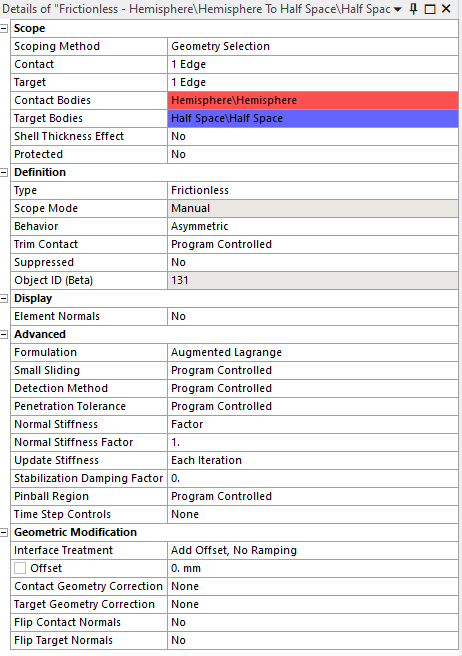

There is no signs of deformations and the stress is for some reason calculated only in the plate with really low values. Below is a picture of me contact setup:
I’ve also noticed that I did two things different from the Cornell tutorial: I defined my geometry in SpaceClaim instead of DesignModeler and I have not unchecked the “Decompose Disjoint Geometry” option in the geometry properties in Workbench.
Thanks again,
Henrique
November 10, 2022 at 11:06 pm
Sean Harvey
Ansys EmployeeHello Henrique,

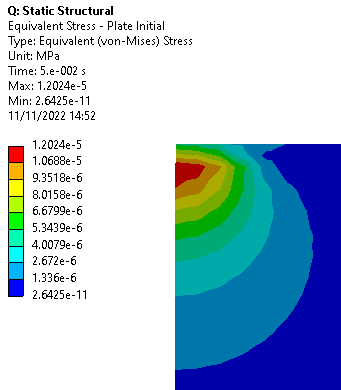

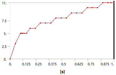

So this was a good finding. It shows that the contact is not being properly detected. You showed the result at time = 1.0 So, you can right click on solution information and insert a contact tracker of type "Number Contacting" So as you make changes, while the solution is running you can monitor this tracker "live" to see if contact is taking place.
With that said, can you share what the contact tracker is showing? The contact side is typically set to contact to report these results but please also share once you have switched to target. (So two plots) If the contact behavior is default this means auto-asymmetric and the contact/target can flip by the solver.
To me, the contact setup looks correct. SpaceClaim vs DesignModeler should not matter nor the other setting.
There is stress in the lower plate, so some force transfer is taking place. Can you also share a plot of just the lower plate stress at first result substep and last (time = 1.0)

I flipped between target and contact (now contact is the plate edge) and with this change the results already changed a lot:
Stress plot on the plate, first load substep:
Stress on both bodies, final:
Number Contacting for the contact side (plate):
The contact between bodies seems to be better resolved now, but not completely. I cannot understand why no stress was calculated in the sphere. Also, I tried solving again for force instead of displacement, and got the same error as initialy.

OK, it is good we are getting contact, and the sub surface stress is something physical that is seen in these problems. You could change the contact behavior to symmetric, and change the pinball radius to a bit larger. The default pinball is a small fraction of the element size, so may try making it like 25% of your element size to see if that helps with the detection. You can do this by changing it to Radius, and then computing this value and entering it.
You may also change the contact detection to nodal projected normal from contact. Try displacement first, then back to force to see if these steps help with the detection.
You mentioned specifying contact stabilization damping, I would go back to that if this won't run and progressively increase until you can run with the force application. You then need to plot the stabilization energy vs stiffness to make sure is small. These are under solution information.
Keep in mind that the adjust to touch will change the physics of the problem slighly by offsetting the contact. While it works very well in many cases, for this case we don't want to be offsetting contacts any as that will change the shape of the bodies at the contact slightly, and if you are studying and trying to match analytical solutions, etc. I can potentially change the results a bit, so eventually, your final model should have this turned off. IMO.
