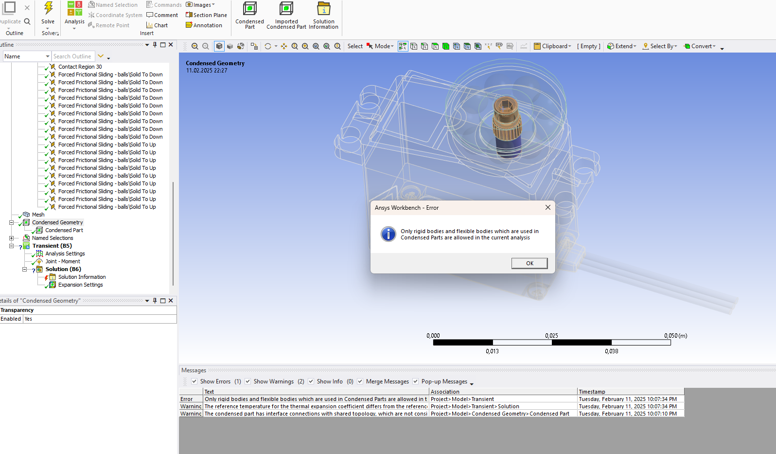

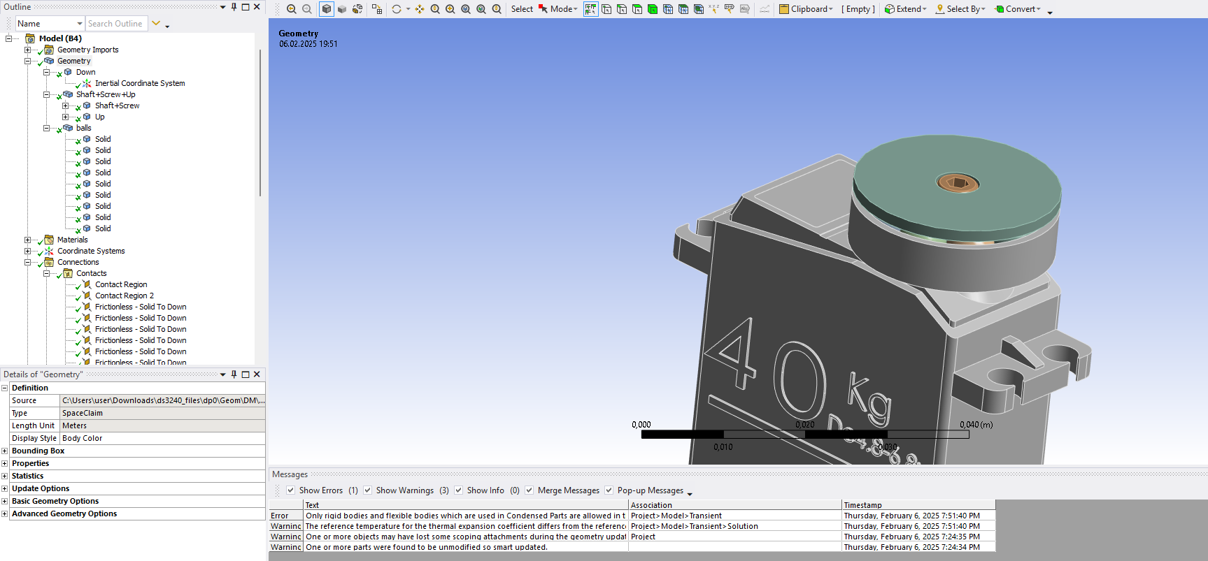

      Hello, I'm designing a bearing in ansys Rigid Dynamics and encountered the error "Only rigid bodies and flexible bodies which are used in Condensed Parts are allowed in the current analysis". I scoured the entire Internet trying to solve this problem. I tried different types of contact and joint.
      My bottom cover is a rigid body, (part of the ground) is a separate component, the balls are a separate component (shared topology - shared) and the top cover is a component. As far as I know, a component in geometry is a condensed part. What should I do? Thanks in advance.

      The message is I hope clear I believe (flexible bodies need to be condensed parts).
      There are some tutorials online about this and how to define condensed parts.
      https://www.youtube.com/watch?v=hKObnqWXf6M
      https://www.youtube.com/watch?v=IXDrYV5JBTc
      For more on theory see our help manual and this course
      https://www.youtube.com/watch?v=OzEEgODBdo4
      https://innovationspace.ansys.com/forum/forums/topic/condensed-geometry/
      All the best
      Erik
      • William D.
