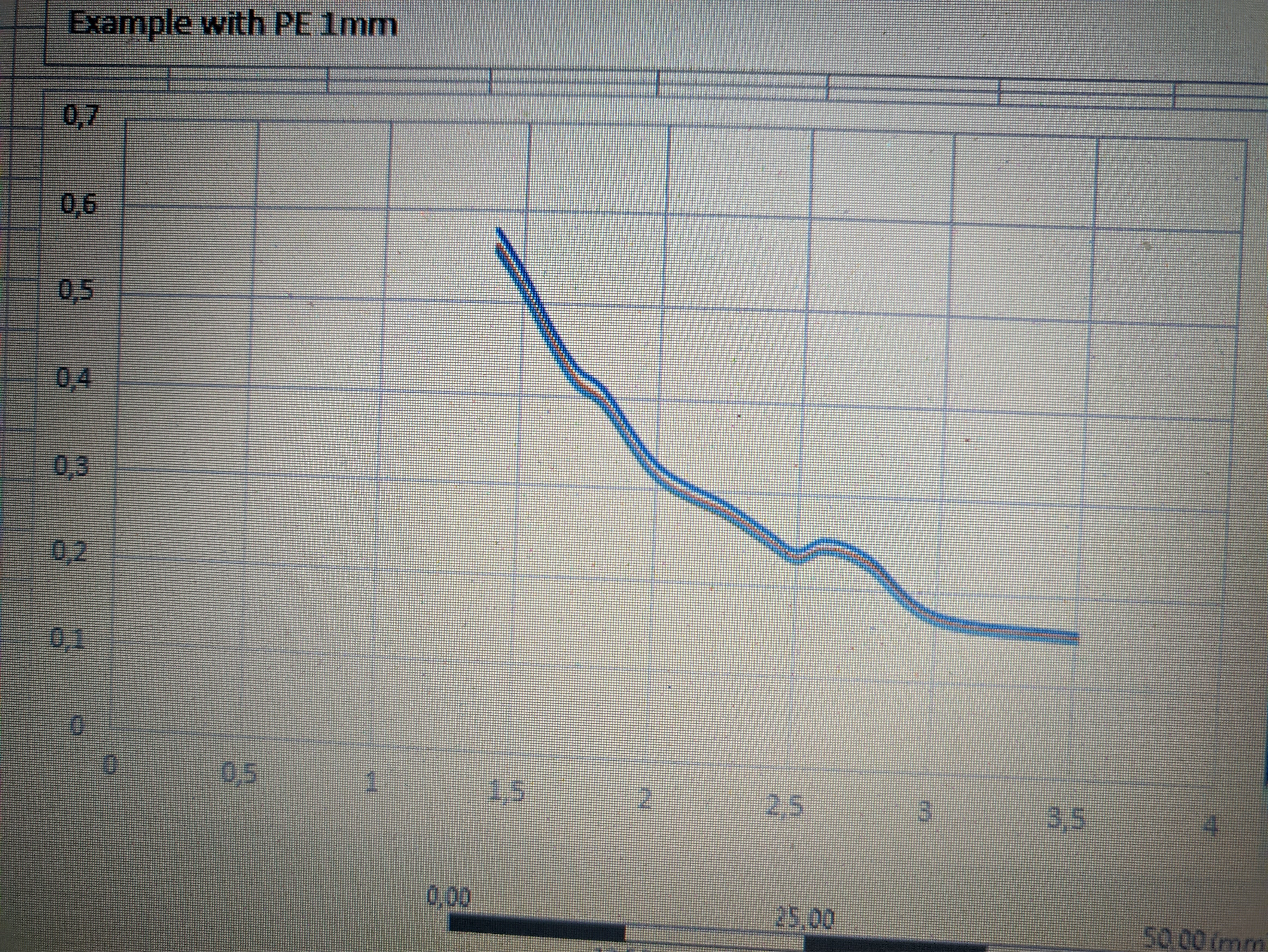

I am trying to do a mesh sensitivity analysis in which I have to find a good mesh size for two bodies in contact with each other. I am applying a simple force to have a contact between (one body is fixed, I apply 1000N to the other one) them and extracting the maximum contact pressure and the maximum Equivalent Stress. Unfortunately I don't have a proper convergence, instead I have strange results. What can I do to have a convergence?
May 25, 2021 at 12:48 pmAkshay Maniyar
I am not sure exactly why you are getting such plots. Can you share some more details of your model? (geometry, materials used, contacts definition etc. )

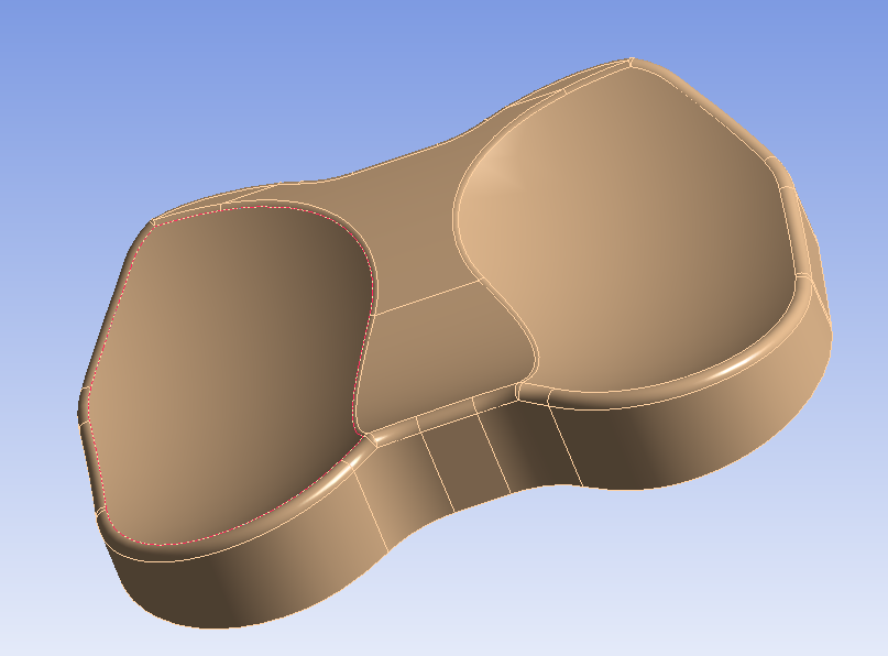

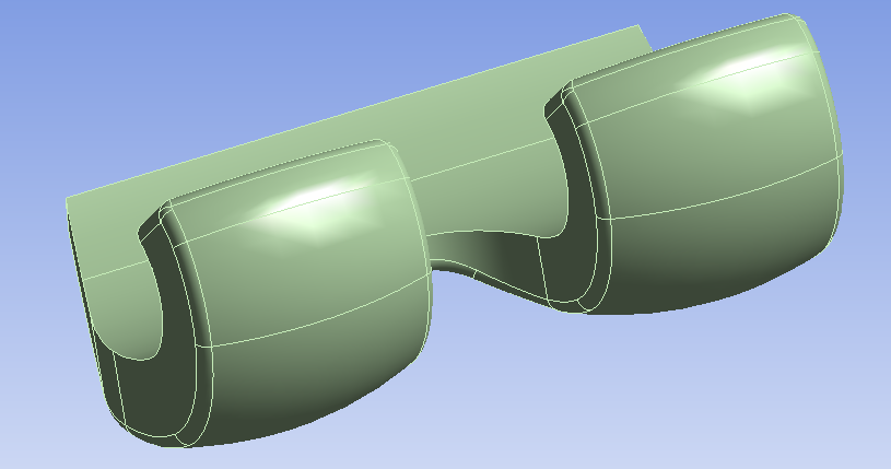

Here are all the information. The bottom object (brown one) is in a generic Polyethilene (from Ansys db) and the upper body in Structural Steel. I have applied a static load ramped of 1000N from the bottom surface of the lower body and it gets in contact with the upper body's surface (which is fixed to the ground).

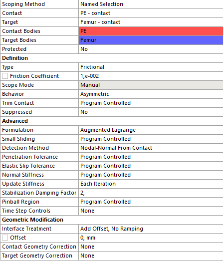

Can you explain what you want to simulate exactly? Also, why you have used the stabilization damping factor as 2?
When you ran your model, is it converging properly or is there any issue? As your frictional coefficient is very less, it might give some problem while converging.
regards amaniyar
May 25, 2021 at 1:45 pmmattobrasil
SubscriberI should simulate a joint and evaluating the reaction moments and contact pressure on the lower body. Damping factor was added for the dynamic simulation and I forgot to put it back to 0. The contact for the plot I sent you is actually Frictionless, but I guess it shouldn't have greatg influence anyway. I also have no problem at all in converging, only the results put together seem oddMay 25, 2021 at 2:05 pmAkshay Maniyar

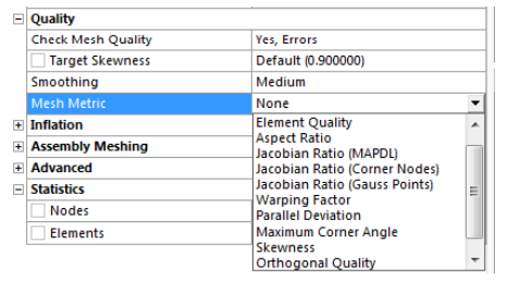

May 26, 2021 at 2:02 pmmattobrasil
SubscriberThank you for the suggestion. How can I check the mesh quality in Amsys mechanical?
