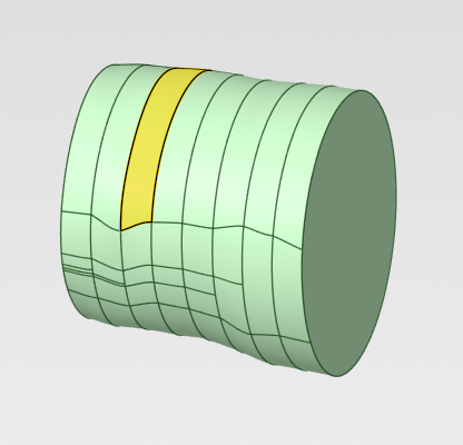

      I am modelling the ports of a cylinder head from a scan and I am having trouble connecting the sketch lines as they are not connected entirely. Fit curve only provides a curve up to the other sketch lines and I end up with a lot of semi circles.
      My plan was to smooth out the curves using "Fit Curves" and then blend all of the surfaces together.
      How do I go about this?

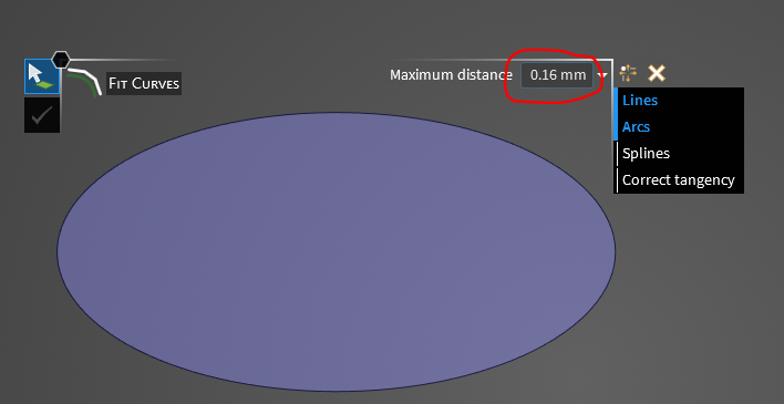

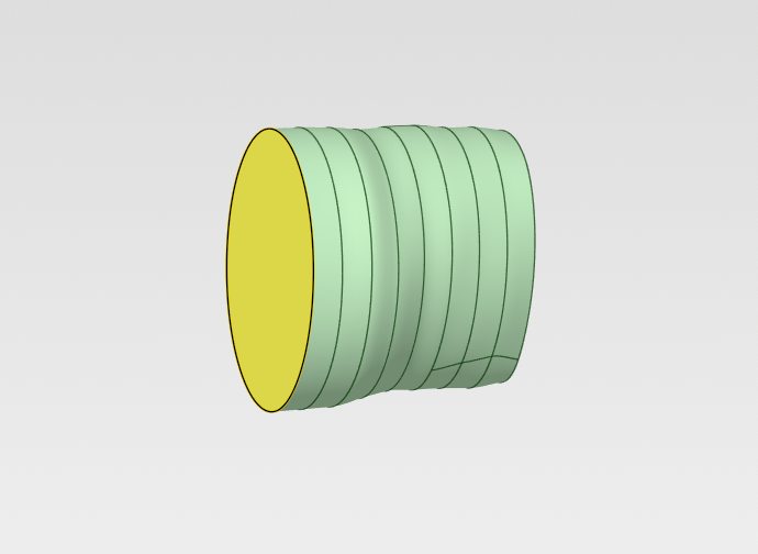

      Did you try chnaging the maximum distance? The other way you try is get two end curves perfect and pull the surface upto other or blend surface between those. You can use repair tools to convert them to solids.
    • Dawid B
      Oh no you are right I made an oversight, I have used it before but forgot to this time.
      I am making the changes now to each surface and will attempt to blend it once the surfaces are cleaned up. If not, I will use the pull tool for 2 surfaces as you recommended.

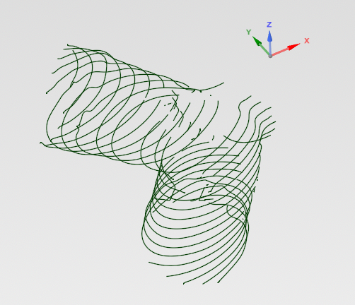

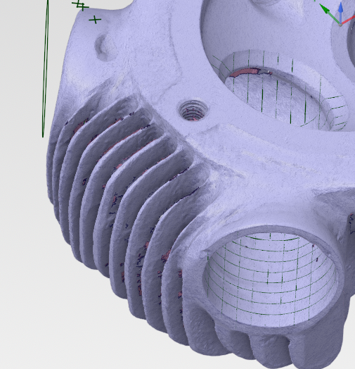

        I have gone about and smoothed out the lines, mainly circles but they turn to ovals towards the end, I have done this from different angles to an origin plane. But seem to still have misalignments upon refinement (due to the scan data and inconsistencies in the original model). I have tried to follow some tutorials to remove points and end points but got restricted on a couple where changing the max distance in the fit curve tool had no effect.
        Is this the best method to go about this? I am trying to go about this the proper way, using 2 perfect surfaces as suggested does not achieve the entire geometry as there are a couple of changes in shape, size and angle.
        Main objective is to capture the geometry as accurately to the scan data as possible.
        (I will try to get some scans of the ports to capture all data points more precisely)
        (I have also attached the sketch curves of both ports across and the scan data for reference)

      The method you did is good way for this but it would need near to perfect curves/arc. From the images it looks there are may gaps in between and patching the surfaces out of it would be difficult.
      You can refer Reverse Engineering in Ansys Discovery | Ansys Courses where there are different ways shown to convert STL mesh file into a workable solid geometry. Same tools are available in SpaceClaim as well.
