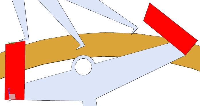

I am interested to see if I can get this model to run. What version of ANSYS are you using?
Please put Assembly.x_t into a zip file and attach that also, since I don't have access to the geometry for editing without that file. [Edit: actually I found it later in the import_files folder]

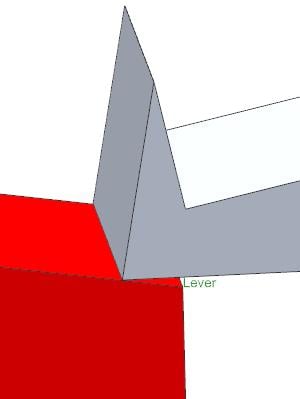

Later today, I am going to (and you can too) add a blend to these two edges, then have one frictionless contact pair that has 3 faces on the contact side and 3 faces on the target side of the contact. That may let the solver "get around the corner".

SubscriberUPDATE: I tried creating miniature blends for your 3 Face - 3 Face contact and it works without an error! Many thanks Peter, I owe you one!Â
Do you have any advice on how to set up the whole motion including the second half cycle (i.e. when the jewel pin swings back due to the hairspring, unlocks the newly locked teeth and locks another one)? Should just I set up another moment at the roller joint after the first swing finished with the same magnitude as before but different direction?Â

Do you mean miniature chamfers (flat face) or blends (cylindrical face) on the former sharp edge? The failure of the algorithm to release the contact at the sharp edge is a defect that ANSYS should fix, but you needed a work around now.
Instead of a moment on the oscillator, which holds the impulse pin, you should put a rotary spring. That spring will have its zero torque angle at the centerline between its pivot and the escapement wheel pivot. Then the mechanism should just keep running forever, powered by the moment on the escapement wheel.

I changed the magnitude of the moment.
IÂ made sure all contacts had Restitution = 0.
Under Solver Controls I added With Inertia Matrix to one of the options.
Sorry, I should have deleted the Named Selection and Parameter, I just had your model open when I was trying to answer a question from another post.
I will mention that I made a version 5 of your model where I tried to make the oscillator wheel turn around again, but then I got convergence issues at times where the version 4 model was already working. That showed how fragile the solution is and that was my sign to stop working on the project and declare victory.
Peter
July 30, 2018 at 4:31 pm
adamkovacs1126
SubscriberDear Peter, I recognised and changed all these settings and yet for me it didn't work. My computer may be cursed or I might have just missed a small detail, could you please take a look at it as a last attempt?
EDIT: I have attached my files to my previous post.
Thanks very much and kind regards,
Adam
August 1, 2018 at 8:45 am
adamkovacs1126
SubscriberHi Peter!
I managed in the end! I also replaced the time varying moment with a constant initial one which works for a really small time period and I gave stiffness to the joint revolute and I was happy to see that it works nicely this way as well.
That means you can define the spring to have 180 degrees of wind-up, as well as a spring rate.
Now I am trying to set up the oscillator as you said but I am a bit stuck. Could you give me any reference reading on how exactly I should define the zero velocity angle for the revolute joint spring so when I configure it manually to start at that angle, then, at the beginning of the simulation, it will start oscillating without any further load applied on it?
Thanks again and kind regards,
Adam
August 1, 2018 at 5:13 pm
peteroznewman
SubscriberHi Adam,
The attached model is (almost) working like you want. I just have a short step 1 that winds the spring up, then deactivate that load in step 2.
Peter
August 3, 2018 at 8:57 am
adamkovacs1126
Thank you very much, I will check your settings!
Kind regards,
Adam
